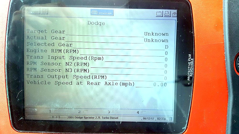

9 years 4 months ago #10276 by Carstuff
Unknown gear selection was created by Carstuff
dodge sprinter
Showing unknown target gear selection. While driving and while vehicle is off.
Symptoms limited to 50mph high rpm
9 years 4 months ago - 9 years 4 months ago #10280 by Andy.MacFadyen
Replied by Andy.MacFadyen on topic Unknown gear selection
Engine RPM not showing either --- no coms.

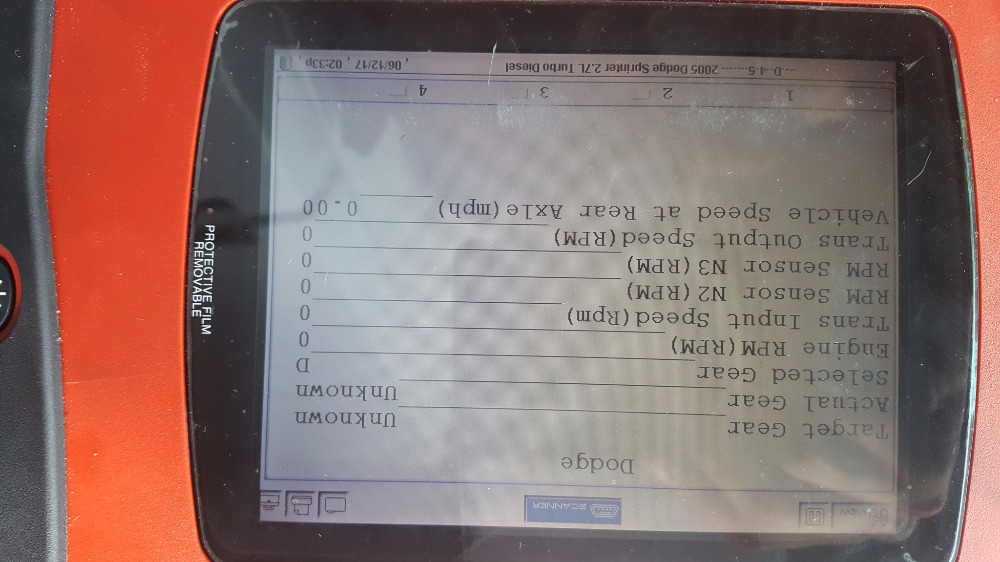

9 years 4 months ago #10282 by Carstuff
Replied by Carstuff on topic Unknown gear selection
The rpm works when driving on the road. This pic was when the vehicle is off with key on.

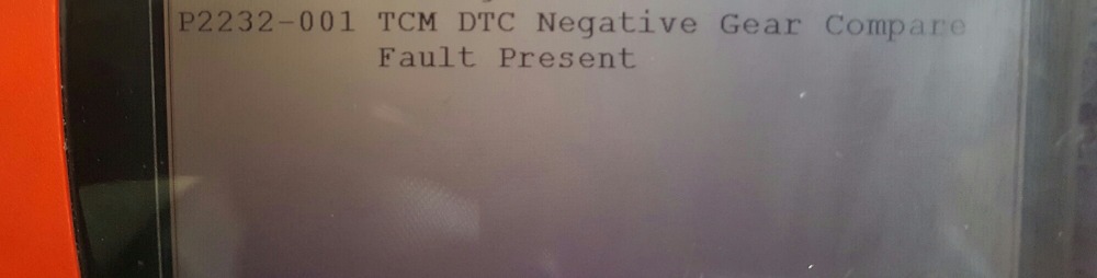

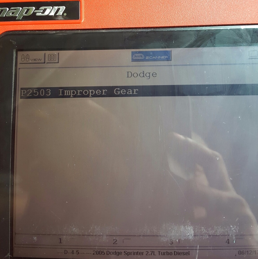

9 years 4 months ago #10326 by Carstuff
Code p2232 and p2503

9 years 4 months ago #10346 by Carstuff
Replied by Carstuff on topic Re:Unknown gear selection
P2503 and p2232
the scanner shows brake light pressed and released so I guess it's working

  • Carstuff
  • Carstuff's Avatar Topic Author
9 years 4 months ago #10357 by Carstuff
The code doesn't say alternator. Not sure why. There is no abs fault.
9 years 4 months ago #10361 by Ben
Replied by Ben on topic Re:Unknown gear selection
Oh huh that's nothing like what generic said those codes were! Guess I should have looked them up for the sprinter specific ... in that case if there's no and codes verify that all the sensors are reading while moving between 1 and 20 mph and none are dropping out if sensors check out then drop then you'll have to drop the transmission pan and inspect the valve body
