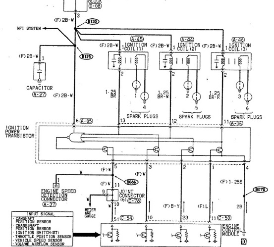

For my reference (and others following), this is the ignition system wiring diagram:
I'm a bit confused about your testing, since you mention testing battery feeds at the PCM and power transistor, but neither one provides battery power on this circuit. The ignition coil primary control wires at pins 11, 12 and 13 can and should pulse a test light connected to B+, but none of the PCM control wires at pins 1, 2 and 3 will. Those are low current 0-4V square waves produced by the PCM. I'm really not trying to lecture! Just want to make sure I understand the testing you've done.
Using the test light I checked for voltage between the PCM and Power Transistor and get a good strong light from the two good feeds but a weak light from the bad feed at both the PCM and Power Transistor ends of the wire.
I think you hit the nail on the head with this test, but I just want to clarify. When you got a weak light, which pin were you touching, and what polarity was your test light connected to?
FYI, I've personally seen two different Montero's with the 3.0L have this exact same symptom, and in both cases it was due to a jumped timing belt. ;-) With the timing out, the cam/crank signals get out of sync, and the PCM stops sending a trigger signal for one of the coils, and you wind up with a two cylinder misfire.
Why doesn't it set cam/crank codes? Good question. :lol: Anyway, before you go much further, I'd suggest pulling the two upper timing belt covers and see if you can line up the timing marks. The other common issue is the crankshaft sensor reluctor slipping off the crank sprocket. The reluctor is roll pinned to the sprocket, and have a tendency to shear off. If this happens, you end up with correct timing belt marks, but an incorrect cam/crank relationship.

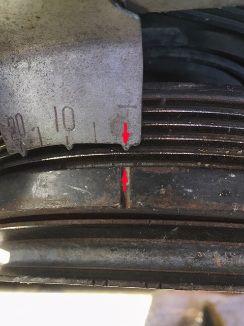

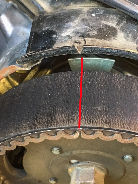

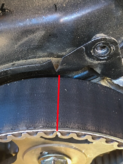

Okay, I thought I would double check my timing and I noticed something the second time around. The first time I lined up the notch on the crank reluctor wheel with the mark on the block and the timing marks on the cams looked like they were on or very close. The second time, I noticed the timing mark on the crank pulley was not exact to the TDC mark on the pulley assembly. So I lined these up exact (photo 1). Then I pulled the pulley assembly off along with the timing covers and the two cam marks were still lined up very close. But the notch on crank reluctor wheel was off slightly. I took a picture of it to get a better look and I noticed dark markings where the crankshaft gear used to be lined up in relation to the reluctor, indicating the plate has slipped from position. I have to work tonight so I will pull this off on my next day off and replace the roll pins (and reluctor if necessary). This just might me what's causing my missing signal to one of the coils.

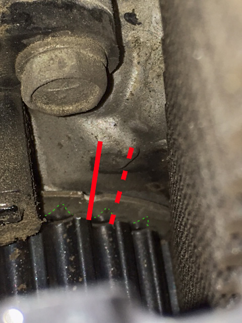

Good eye. B) Let us know what you find! If possible, you can also try using a screwdriver to turn the reluctor independent of the crank sprocket? Obviously, if you can spin it, then there's a problem.

9 years 4 months ago - 9 years 4 months ago #10472 by shepherdguy
Just an update:
I removed the crankshaft gear and reluctor plate. At first, I was concerned it might not have been the issue after all because when I flipped it over both pins were protruding through the collar. but when I tried to wiggle it back-and-forth, I noticed that one of the pins was sheared allowing the collar and reluctor plate to shift back and forth. I was unable to remove the pin half inside the gear and even broke off a small drill bit trying to drill it out. I am ordering a new gear set with new reluctor plate, pins, and collar.

9 years 4 months ago #10475 by Tyler
shepherdguy wrote: Just an update:
Thanks for the update! Well done catching the sheared pin. Brilliant design, eh? :lol: I've tried repinning these, and never had much luck. Please let us know how this ends up once you've got the timing put back together?

Reposting the ignition system diagram for easy reference:
All three black/white wires at each coil should shine bright with the test light connected to B-. The control wires at each coil (brown, brown/white, brown/red) should pulse with the test light connected to B+. Do both with the engine running.
At the power transistor, pin 6 black/white should be steady power, and pin 4 black should be steady ground. You said pins 11, 12, and 13 pulsed the test light connected to B+ earlier, but maybe check again?
Pins 1, 2 and 3 will have 0-4V 'ramps' when the PCM wants to command ignition dwell and spark. Checking for control is gonna be tough with a test light or DMM, as neither is gonna be able to detect the ramps. If you really want to 'see' the control, it'll have to be a scope. :unsure:
But! You can try a 'scratch test' on the wires between the PCM and power transistor. Check out this video for the general idea:
Your Mitsu doesn't use three-wire COP's, I know, but the control system really is the same. ;-) The power transistor charges the ignition coils based on the ramps sent from the PCM. You'll just be simulating those ramps with the test light.
Basically, if you can backprobe the PCM wire at the power transistor that correlates to the coil that isn't firing, and use the test light to make the coil fire, then you know the power transistor is working. Repeat the same test at the PCM connector. If you can make the coil fire at the power transistor, but not at the PCM, then there's a wiring problem.
That test won't tell you if there's control or not, but it WILL tell you wiring integrity and the health of the power transistor. Making sense? Ask questions as needed!
