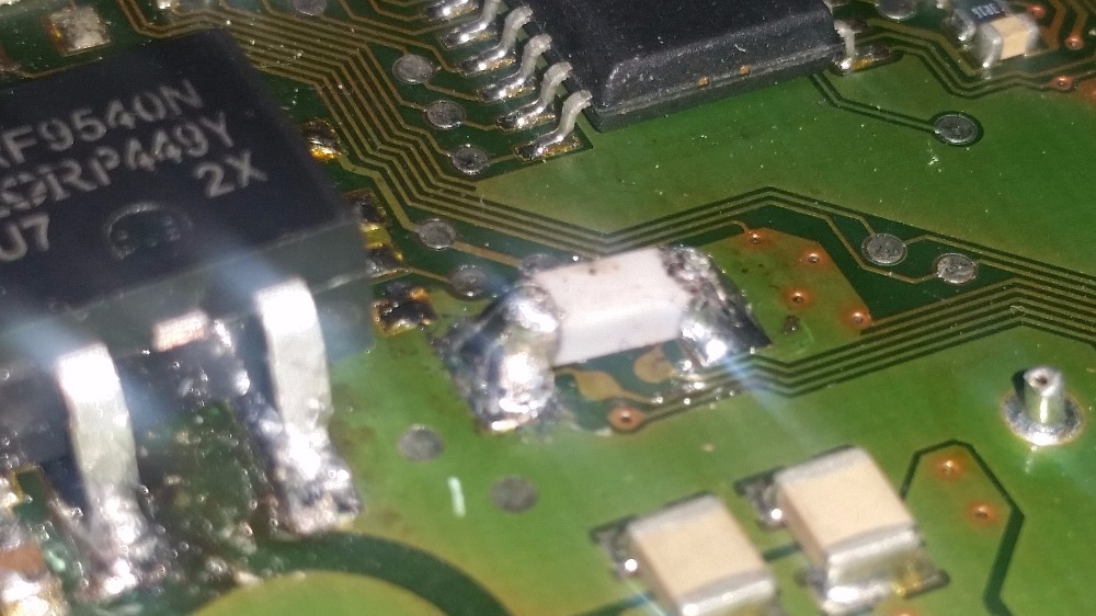

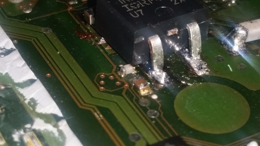

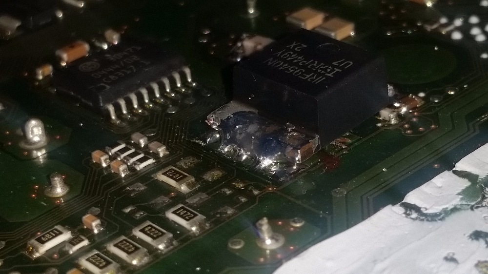

  • AlphaMM's Avatar Topic Author
9 years 4 months ago #10331 by AlphaMM
Replied by AlphaMM on topic VW GOLF NO START AFTER JUMP STARTING
these 3 photos are after the 2nd repair

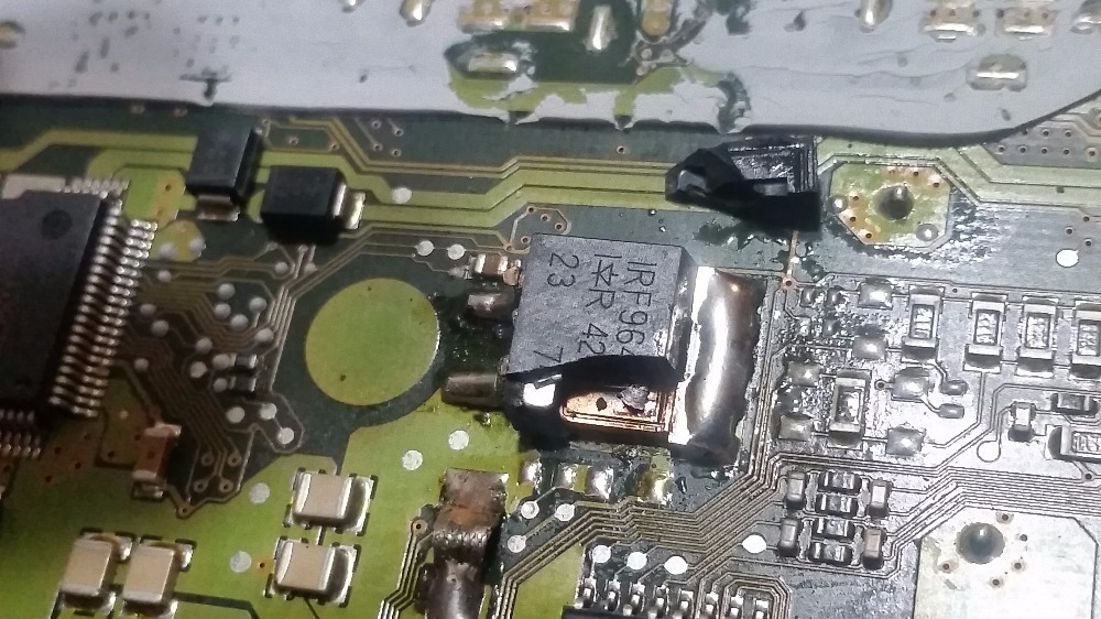

  • AlphaMM
9 years 4 months ago #10332 by AlphaMM
this photo is after the 1st repair right after I plugged Ecu on and turned ignition on. what I noticed is that the part numbers are different, that means he put different parts both times
9 years 4 months ago #10333 by Ben
Replied by Ben on topic Re:VW GOLF NO START AFTER JUMP STARTING
Wow that looks horrible I think you should look for a used ecm as that thing is probably fried from solder cross bridging onto other circuits someone used way to big of a soldering iron for that repair!

9 years 4 months ago #10336 by Ben
Yes that was a horrible repair when done right it's hard to tell the difference from factory your repairman had no business in an ecu that might fly in a old tube tv but not an ecu!

  • AlphaMM
9 years 4 months ago #10625 by AlphaMM
Replied by AlphaMM on topic Re:VW GOLF NO START AFTER JUMP STARTING
Hi guys, car is running now. It was the ecu as I first thought! the guy that done the ecu repair had no idea what he was doing which turned me into the wrong direction thinking I missed something. Pretty much I have striped the whole trying to find a ghost. ..
Sent from my SM-G900I using Tapatalk
9 years 4 months ago #10627 by Ben
Great ! That's the problem with backyard repairs they may not be of good quality....
