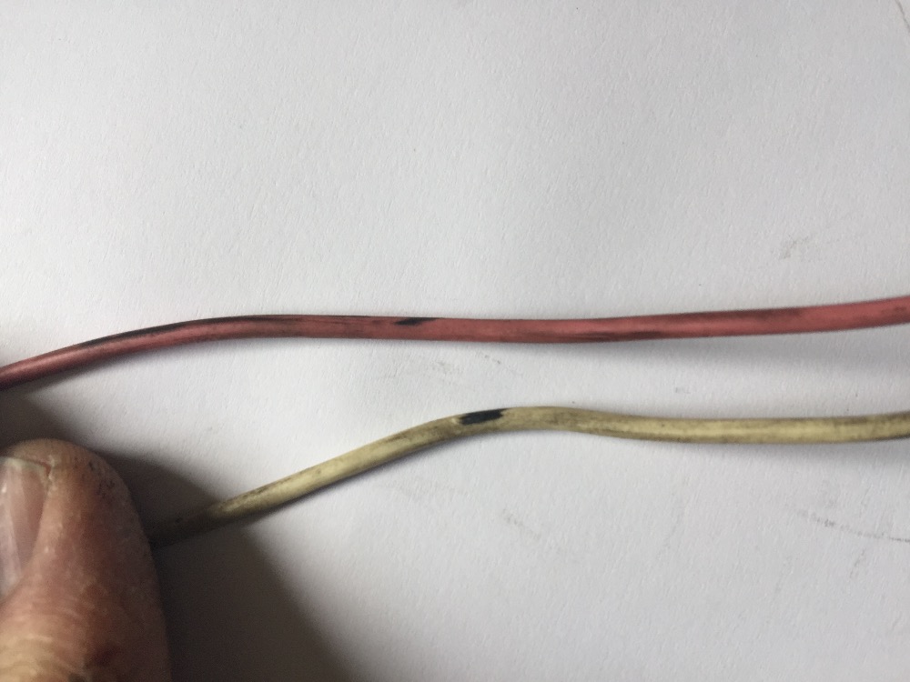

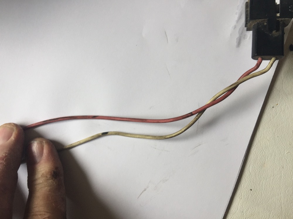

  • popoften
9 years 4 months ago #10605 by popoften
Replied by popoften on topic 1994 Chevy Suburban C1500 - cranking, no start
I left the truck running in my driveway for two hours, it did not stall out. I did notice that the two wires ( a pink wire and a white wire) were resting on an edge of intake manifold between the coil (where one end of the wires' connector plugs in) and the base of the distributor (where the connector with the other ends of these wires plugs in). The insulation on each of the wires is burned where they were resting on the edge of the manifold. Though not burned all the way through. My guess is that with heat and vibration high resistance resulted, interrupting the spark. I am going to fix these wires so I can at least eliminate these as a variable.

  • popoften
9 years 4 months ago - 9 years 4 months ago #10684 by popoften
I can see the injectors spraying into the throttle body during the crank/no start. Also, the engine always starts again once it cools all the way down. I repaired those wires in the pic, and have put the truck back on the road. If it makes it at least a week without stalling out, I am calling it a fix. :-)

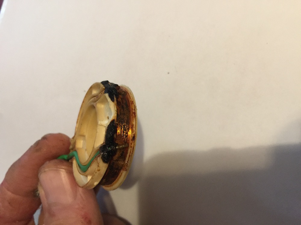

  • popoften
9 years 2 months ago - 9 years 2 months ago #11649 by popoften
Time for me to work on this problem has been even more intermittent than the problem itself. Now that the truck has been sitting in my driveway for a month, I have finally had a chance to check the pickup coil in the distributor. The insulation on the white and green wires was heavily cracked, every quarter centimeter or so, and the winding itself was in really bad shape.
I replaced, and drove the truck almost 200 miles today and it is running fine.
Thank you for all your insights, guys!

  • popoften
9 years 2 months ago #11650 by popoften
Here is a pic of the old pickup coil.
