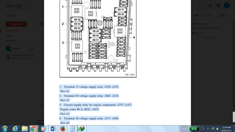

I have golf 5 , tdi 2005 1.9 diesel. crank ok but No start when no glow plug light, and no engine lamp. After few homes closing and opening the key randomly if the both light comes in the dash ,the car can start normally without problem. I almost check all the ground and power in ecu and i could not find any problem. I have 4 relay in engine fuse box . 2 × 453 and two 433 in engine bay +1 glow plug relay. Inside the car i have 66 relays. And i almost check all the relay 1 number 53 and one 460 and a four small relay.
I almost spend more than 12 hour. And still stocking with this car.... please help me.
I know most of the case same situation like j371, but I can not find and actually I doubt about having j371 in this model ( actualy I short out all the relayes manually.)
I can connect with the ecu with my scan tool. I dont get any number in No mil ( engine check light ) Iresponse and the fault code is :
Relay for Supply Voltage Terminal 30 (J317)
P1601 - 35-00 - Implausible Signal

9 years 4 months ago #10451
by RR-Auto
Replied by RR-Auto on topic golf 5 tdi 1.9 2005 ,crank ok,random no glow plug light no engine lamp no start
a little update.
(all input and outputs seems ok on j317)
but I have no inout of 85 , 86 On j757 relay. I dont know what exactly it supplies to . but I get no difference by shorting the output to 12 v . Or even when I get the MiL light on and I can start the car, This relay still has no input inside.
Since everything sounds ok , my last doubt is about self-diagnostic module. I really dont know how does it work ...
Smurf786;3056374 wrote: Have you done a full diagnostic scan? See if any faults?

Take a look at your load reduction relay In the auxiliary relay panel on left side of dash. Also when its acting up check power on fuse 5 ,10 and fuse 29 in same fuse box with key on

Next time you try to start the car and you have no glow plug light, open your bonnet pull the lid off the fuse box, there is a relay usually with 317 in there. ( take it out and use a piece of wire to cross the wires on the load side, the car should start normally if that's the problem),if this doesn't work the rest of my info isn't much use in this case. If I remember correctly the ecu sends out a ground signal to the control side of the relay and this power up sensors.......anyway the wire from the control side of the relay breaks usually a few inches from the fuse box, this wire goes directly to the ECU, think it could be pin 49 on ECU plug.
Before you do too much, with the ignition on check to see if your power and ground are ok on the control side of the relay.
The relay itself also give trouble, let us know how you go
