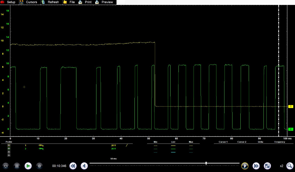

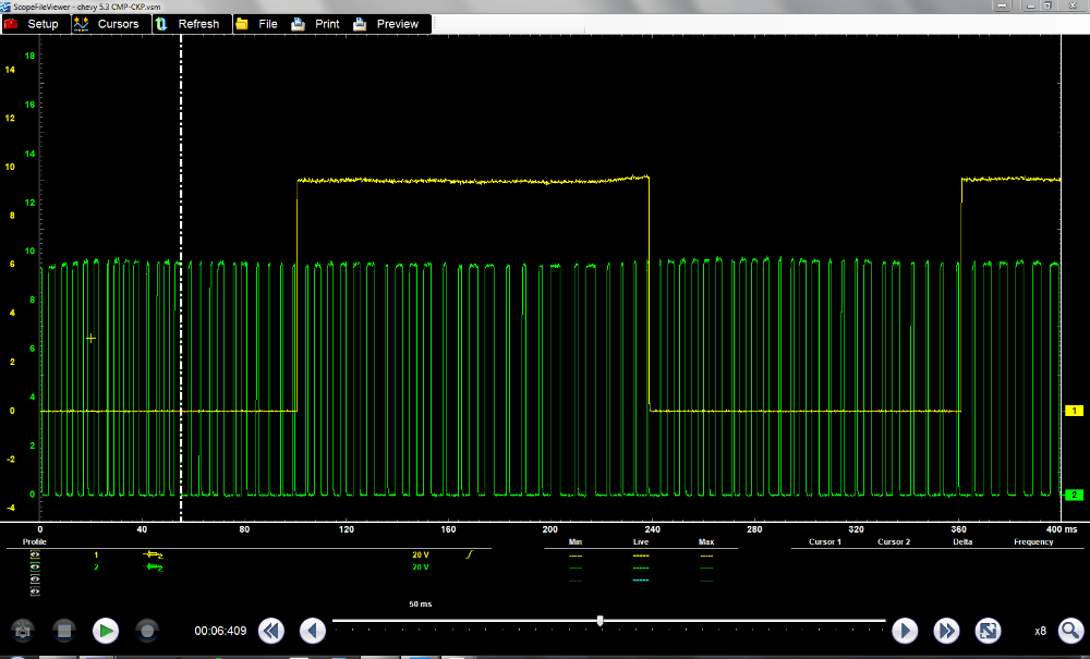

9 years 4 months ago #10473 by jaivs26
Replied by jaivs26 on topic Re:2001 Chevy Tahoe 5.3 No Spark In 3 Cyl.
Here is the waveform!
9 years 4 months ago #10476 by Tyler
Replied by Tyler on topic Re:2001 Chevy Tahoe 5.3 No Spark In 3 Cyl.
Thanks, sir! Could you email me that VSM file? wrenchturnsyou@gmail.com
I'm interested to take a closer look, as it appears that the last pulse of the CKP gets cut off by the end of the CMP pulse. Might just be the way the image came out?
9 years 4 months ago #10494 by Tyler
Thanks for the waveform! Had a look, counted the CKP pulses. Definitely had all 24 pulses within the CMP window. I got a little concerned at how close the last pulse is to the end of the CMP, but I'm not convinced this is the issue:
This was during cranking, correct? Do the same three coil not have spark during cranking, as well as idling?

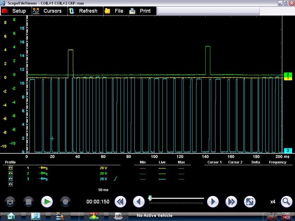

  • jaivs26
  • jaivs26's Avatar Topic Author
9 years 4 months ago - 9 years 4 months ago #10504 by jaivs26
Replied by jaivs26 on topic 2001 Chevy Tahoe 5.3 No Spark In 3 Cyl.
Here is a screenshot of the CKP,CMP and coil #5 on initial cranking .. it's getting just one or some times 2 signals every time i first crank the engine.
i checked the other "2 faulty" (coils 7 and 8 ) coils and i'm not getting any signal at all on initial cranking.
Last edit: 9 years 4 months ago by jaivs26.

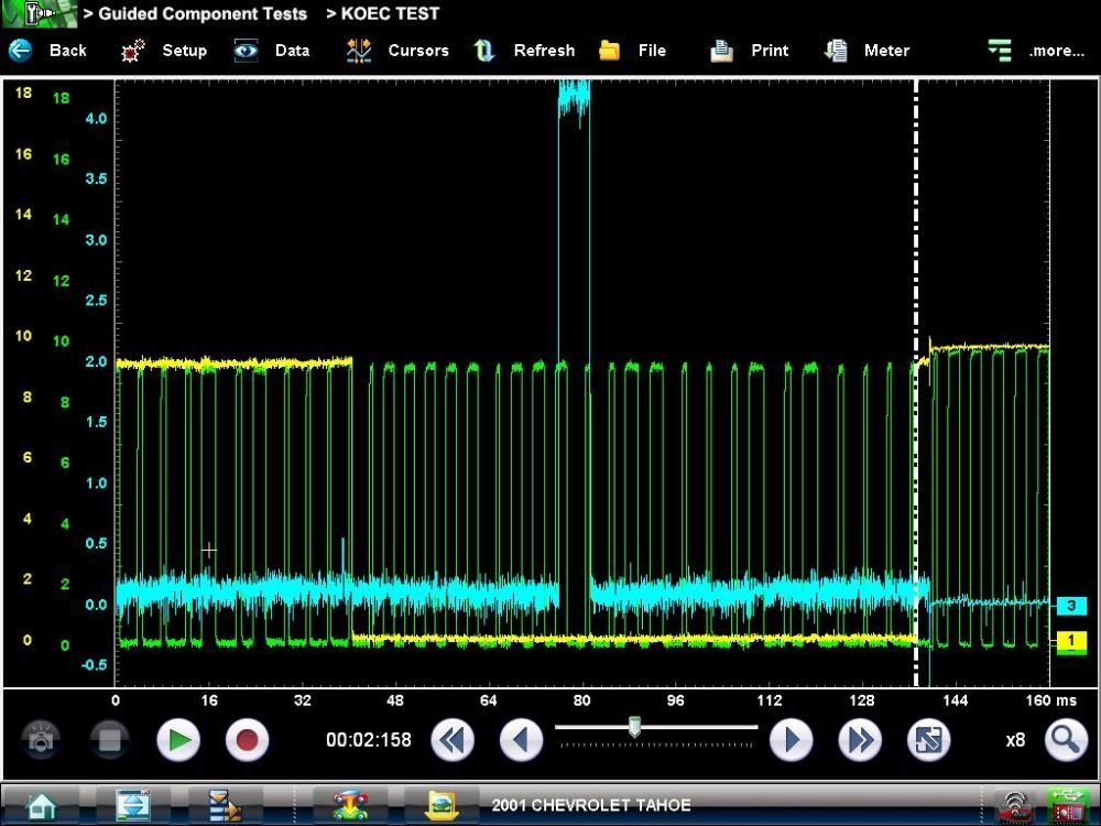

  • jaivs26
9 years 4 months ago #10536 by jaivs26
HI NOAH!
Here is a capture of a CKP( BLUE) COIL#1 (YEL) COIL #2 (GREEN). I connected the ground at the battery. And to be honest i can't remember where i connected the ground when i test the COIL#5..
i think the noise it's because the starter is cranking the engine! don't you think ? i did notice the noise but i just tired of this truck that i didn't care much.. but tomorrow i will check it again to make sure where i connect the ground..

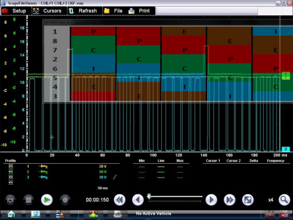

9 years 4 months ago - 9 years 4 months ago #10566 by Tyler
Replied by Tyler on topic 2001 Chevy Tahoe 5.3 No Spark In 3 Cyl.
So I've been beating my head against the wall on this one. :lol: To be completely honest, I probably would have broken down and tried a crank sensor already.
Started thinking about the cylinders that are missing spark. The firing order is 1-8-7-2-6-5-4-3 on this engine, which slices up like this:
1-8-7-2
6-5-4-3
So #8 and #5 are companions, two of the cylinders we're missing spark on! #7 is just after #8, so maybe there's something to that? Anyway, I started wondering if there's something wrong with the crankshaft reluctor, as #5 and #8 are 360 crankshaft degrees away from each other.
Threw the overlay program up over the coil trigger waveform jaivs26 posted, hoping to associate crank pulse groups with specific cylinders.
If I did it right, then it's the second group that's associated with #5 and #8. The short-long-long-long group, right after the initial short-long-long-long-long-long. But, I can't find anything wrong with it! :lol: :silly:

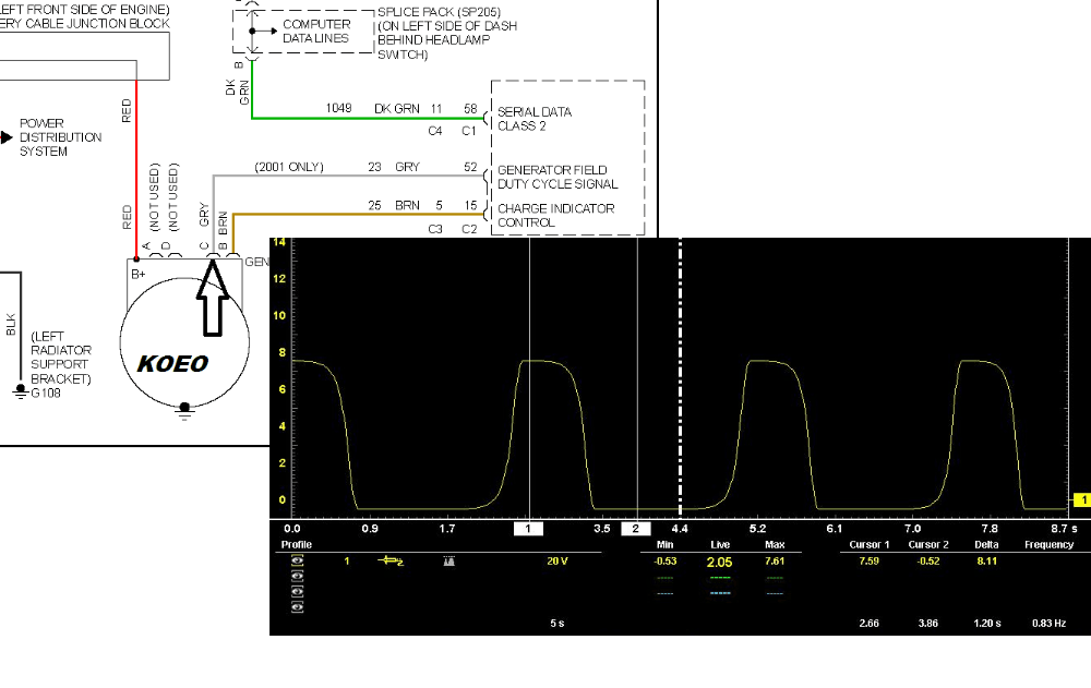

9 years 4 months ago - 9 years 4 months ago #10573 by jaivs26
I want to thank everyone for helping me with this problem. All have been very helpful!!
today i was checking it again a notice that the alternator was getting hot just a few minutes when the engine was running.
and something weird to me happened the engine start to get more speed. Unfortunately it didn't fix anything.
I tested the alternator with the KOEO and heres the capture
I also recored a small clip when i found this

9 years 4 months ago #10578 by Tyler
I can't watch that video right now. :-( But it seems like unplugging the alternator improves the symptoms? I'd be interested to know how much AC ripple is present at the battery.
Thinking back now, that'd probably explain all the noise in the CKP signal peaks...
