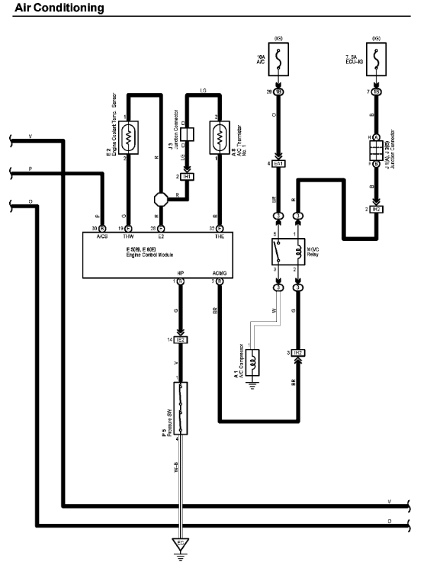

3 years 2 months ago #62691 by Tyler
Replied by Tyler on topic Oh no, AC acting weird
Relays can act up intermittently, sure. Some Toyota products were known for relay issues. But I think I'd start with checking for power at the compressor clutch when the clutch does not engage.
If you have power at the clutch but no engagement, then either the clutch has failed electrically, or it has excessive air gap. Replace the clutch or the compressor. If you do not have power at the clutch, then go down the relay path.
Get eyes on the compressor clutch connector (or the wiring to it) and decide where/how you're going to test when you catch it not blowing cold. DMM would be fine, test light would be better. A service info subscription would definitely help in identifying the compressor clutch circuit. I snipped the relevant diagram from  charm.li/ :

3 years 2 months ago #62702 by SheetsTech
Replied by SheetsTech on topic Oh no, AC acting weird
That's a great link, Thanks!

3 years 2 months ago #62799 by Noah
Replied by Noah on topic Oh no, AC acting weird
Were you able to check for power at the compressor as Tyler suggested when the AC is not working?
That test would determin if this is a problem with the compressor, or a control issue.
