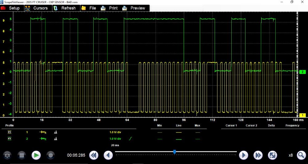

9 years 4 months ago - 9 years 4 months ago #10461 by jose.alers
2006 PT cruiser 2.4 was created by jose.alers
non turbo. Anyone have a cam/ckp waveform?

9 years 4 months ago #10530 by Ro-longo
Replied by Ro-longo on topic Re:2006 PT cruiser 2.4
Don't know if they are the same but here is one from a 2005.
Yellow = CKP
Green = CMP
