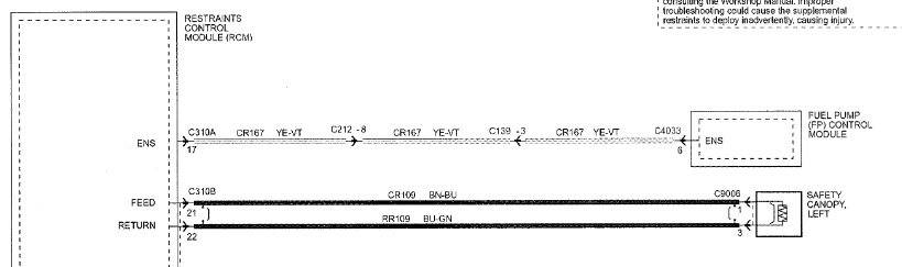

2010 Expedition u210b lost coms between FPCM and restraint control module. Anyone know what the signal is supposed to look like between the 2 modules?

9 years 4 months ago #10523 by Tyler
Replied by Tyler on topic 2010 Expedition u210b
I wonder if that code is referring to this circuit instead:
I'd be interested to know what the voltage levels on this circuit are with everything connected, and the FPDM disconnected.

9 years 4 months ago #10548 by Tyler
Replied by Tyler on topic Re:2010 Expedition u210b
Did a bit of research on this one. The FPDM provides at least 10V on this ENS wire to the RCM. If you find at least 10V at the RCM pin, then the flow chart says replace the RCM.
If you do not find voltage, then go the FPDM and recheck. If you still don't have voltage, then check pin fitment and FPDM power/ground before replacing the FPDM. If you Do find voltage, then check the ENS circuit for an open/high resistance.
Condensed the flow chart for ya. :lol:

9 years 4 months ago #10562 by bruce.oliver
Replied by bruce.oliver on topic Re:2010 Expedition u210b
No symptoms.
Yes it is the ENS circuit. I already went through the testing and we have a RCM on order.
With everything plugged in, RCM and FPDM, the ENS wire is grounded. Still grounded when I unplug the FPDM. With both unplugged the wire has nothing on it. With the FPDM plugged in and the RCM unplugged the wire has 12 volts on it.

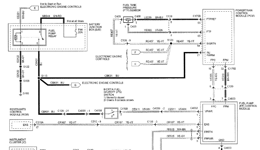

9 years 4 months ago #10615 by Tyler
bruce.oliver wrote: It doesn't have an inertia switch. The ENS circuit takes its place
Really? :huh: The diagram I found still has the inertia switch in it.
Not arguing with you at all, just not sure why they're doubling up like this.

9 years 4 months ago #10634 by Tyler
bruce.oliver wrote: The description on prodemand for the ENS circuit said it replaced the inertia switch. I'll go back and reread it and check to see if it has an inertia switch whenever we get it back for the RCM.
Sweet! Wouldn't be the first time a diagram was wrong, either. :lol: I'm guessing this Expedition still starts and runs, right? Wondering if this circuit can cause a no start...

9 years 4 months ago #10678 by bruce.oliver
It dones have an inertia switch in the left rear corner.
New RCM installed and programmed. KOEO and KOER the ENS circuit has a 0-12v squarewave. With the old RCM it had constant 0v
