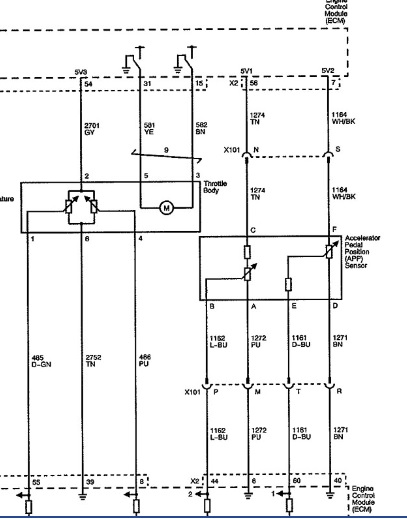

In looking at my Mitchell wiring diagram and several diagrams I found online it appears the TAC module does not get the 5 volt reference from the ECM and that it makes it on its own but I'm not positive on that. I can upload my wiring diagrams if you need to see them I just don't want to condemn this module if there is any chance it is not bad.

It's a little late now, but here's the GM diagram for this same system. I love Mitchell diagrams, but they do leave crucial details out...
Looks like X101 is the suspect connector?
