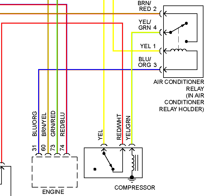

PLEASE HELP WORKING ON A 1997 SUBARU LEGACY OUTBACK COMPUTER NOT SENDING CONTROL TO AC COMPRESSOR RELAY
NO CONTROL FROM COMPUTER TO BLUE ORG WIRE

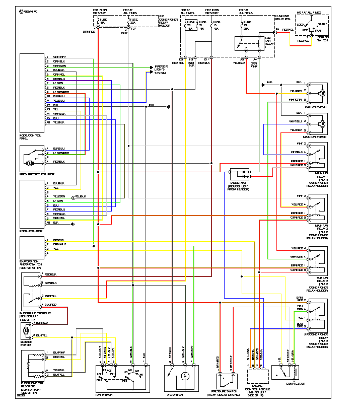

9 years 4 months ago #10559 by Ben
Need more than that snippet of diagram where are the pressure switches?

9 years 4 months ago #10588 by Ben
I love Mitchell diagrams I just can never make put what they say unless there zoomed in . With that said you'll have to look for me where do the pressure sensors signal go do they go to the PCM or do they go inline with the compressor ? Have you checked your pressure? How many pins on the pressure switches? If there just 2 pin pressure switches they are easily bypass tested . Also could be a wiring issue as Cheryl suggested checking at PCM but I usually find it's a input problem

9 years 4 months ago #10593 by KEVIN777
thank for the reply guys! so there is no scan data pid on this car, also i did check the computer side wire there is no open. the pressure switch works and it is 2 pin connector according to mitchell description it says apply ground on pin 61 ecm connector if compressor not engaging replace ecm I ordered used ecm will recive on june 27 lets see what happens with known good ecm thanks again for taking time and replying .

9 years 4 months ago #10618 by Tyler
Hey Kevin! Did you have a chance to look at the coolant temp on the scan data? Just thinking about ECM inputs, and it'll shut the A/C off if it thinks the engine is overheating.
Also, have you looked at the brown/yellow wire from the evaporator thermoswitch? That looks like another ECM input, probably to make sure that the evaporator isn't icing over. That same switch in involved in providing power to the A/C clutch control side - do you have power there?
