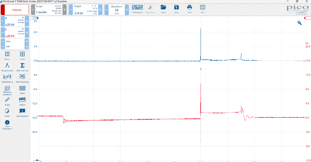

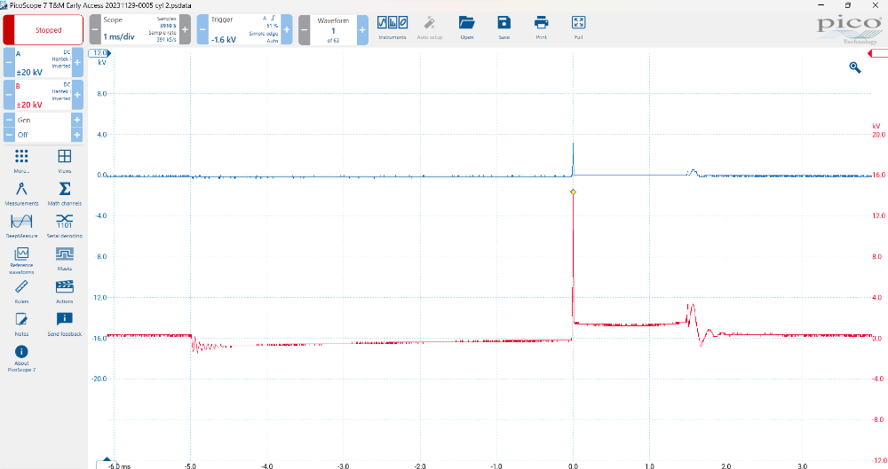

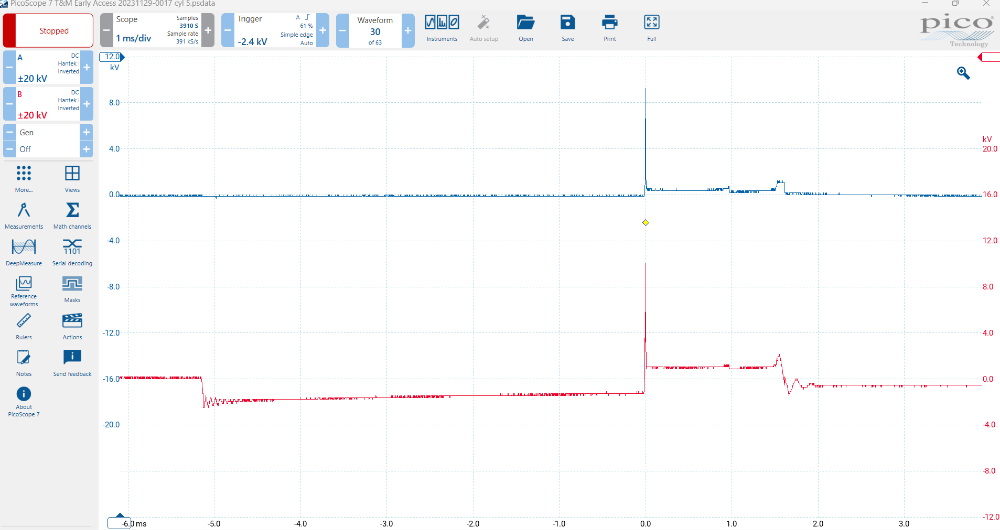

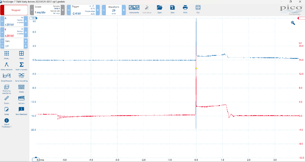

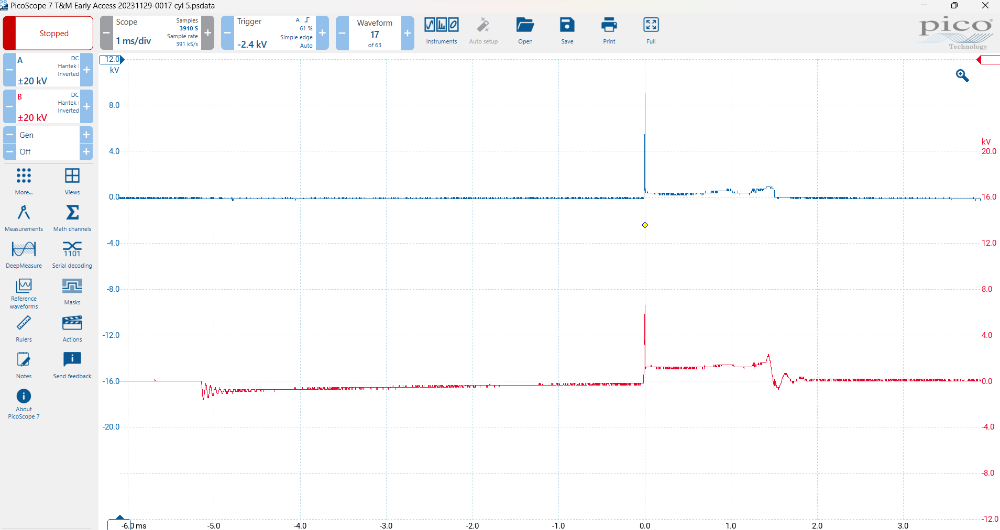

OK - ran some secondary ign scopes on each of the six cylinders ( set scope to the 1ms/s, one lead on the dist coil wire, 2nd lead on each individual cylinder plug wire). Cylinder 5 has what I think are lean patterns that occur randomly but frequent (within about every 10 cycles) and have up to 3 of these patterns in a row (see pict 1)(pict 2 is the next pattern on cyl 5 right after pict 1 - looks normal?). Cylinder 5 also has what I think are low or weak spark lines? (as low as 8 KV see pict 3). There are also some patterns that have the spark line spike down below zero, not sure what that is, but that seems to happen before the lean patterns start (see pict 4). Cylinder 6 has same patterns as cylinder 5 but not as many. Cylinder 1 and 3 have same pattern, but much less frequent, Cylinders 2 and 4 do not have these patterns and look pretty good to me? (see pict 5)
what do you guys see in these patterns?

second pict

3rd pict - cyl 5 low spark kv

pict 4 - cyl 5 spark line below zero

pict 5 - cyl 2 - looks normal?
