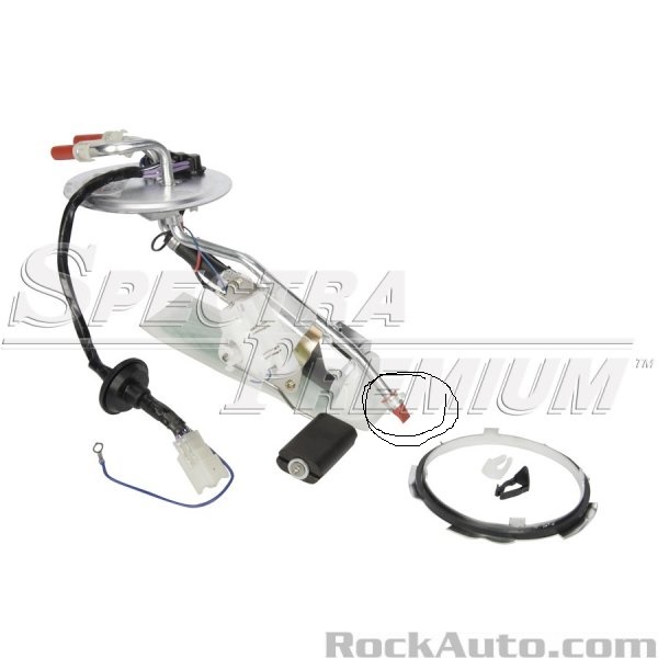

Whats this piece of rubber on fuel assembly for?
- Donnyten
- Posts: 120
- Thank you received: 2
9 years 4 months ago - 9 years 4 months ago #10665
by Donnyten
Whats this piece of rubber on fuel assembly for? was created by Donnyten
Last edit: 9 years 4 months ago by Donnyten.
9 years 4 months ago #10666
Replied by Noah on topic Whats this piece of rubber on fuel assembly for?
I always kind of figured that was there to keep fuel in the line when you turn the car off.
It looks like any pressurized fuel would overcome the little diaphragm, but under rest it would close up.
Now that I have to explain it to someone else, I'm not so sure I'm right, lol!
It might just keep crap out of the tube to ensure that the return line doesn't become blocked in the tank.

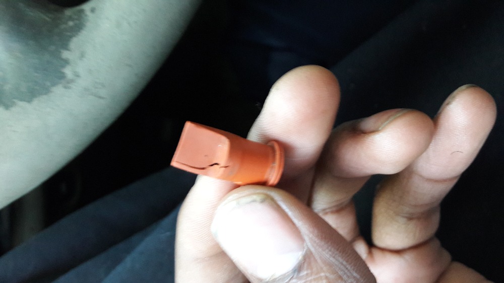

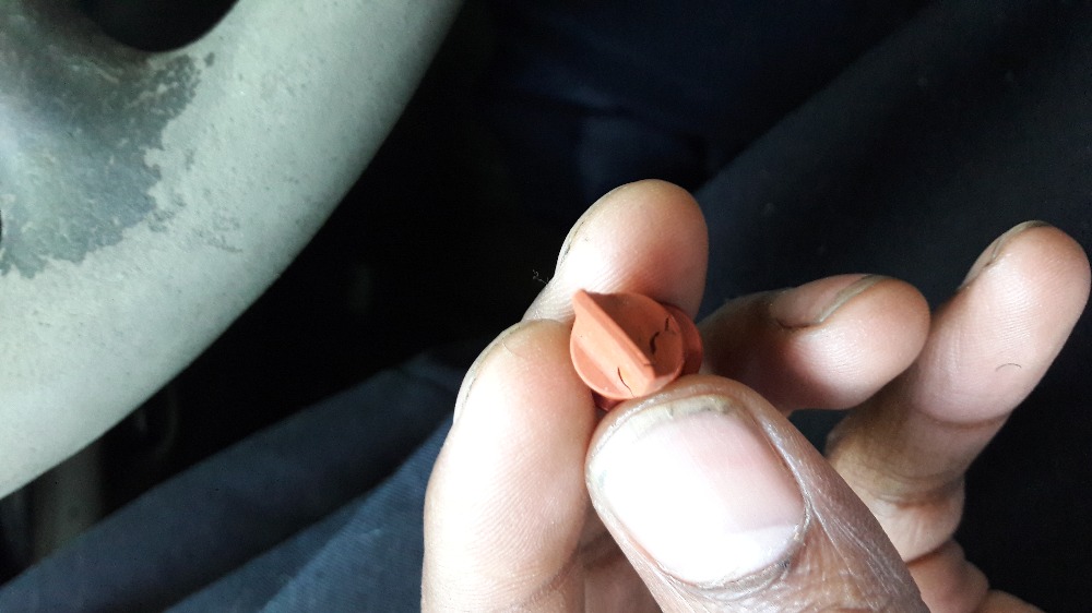

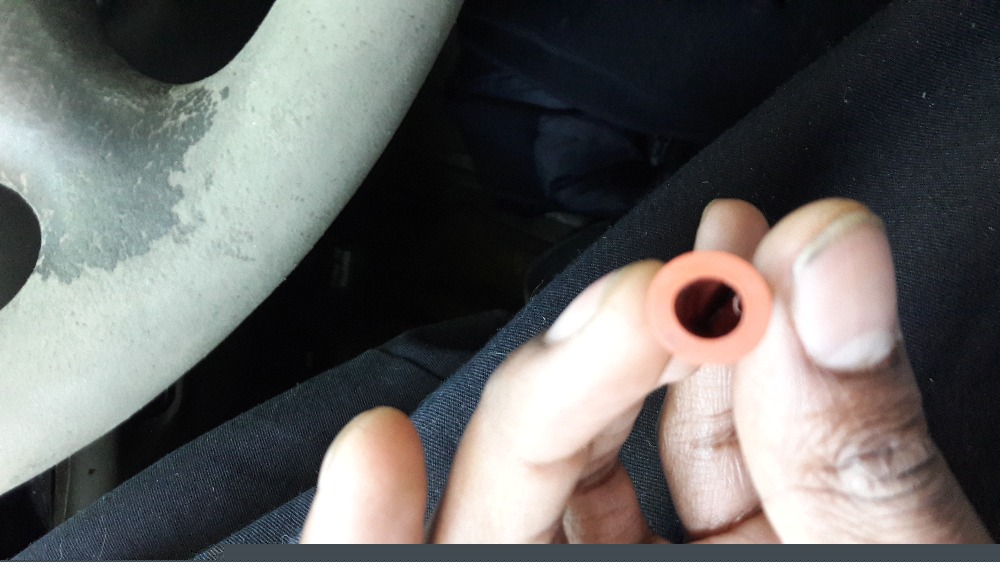

Noah thanks for the fast reply. What do you think I can replace it with? I doubt AutoZone or local auto parts store would have this part but I'm sure I could wrap it with somethin. but if it's designed to expand under pressure and close while not under pressure then I could end up screwing it up. here's the torn piece from the pump.

It looks to me like a duckbill check valve. I am betting that the very tip is slotted to allow fuel to flow into the tank but cannot backup the other direction into the tube.
