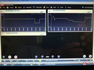

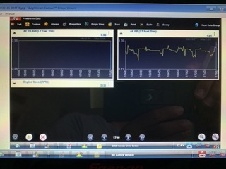

2 years 11 months ago #63517 by Mechanic 350

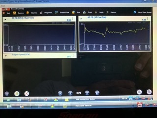

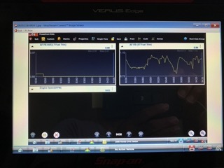

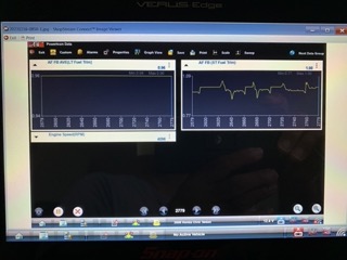

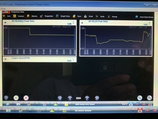

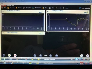

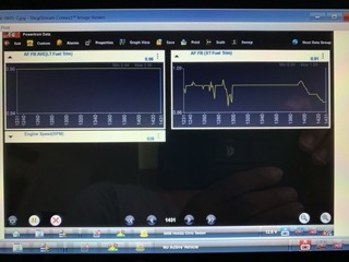

I figured out how to take the captured photos. Now, where can i find the screened shot photos along with the .vsm file. I think i saw 7,000 plus frames while I was test driving the vehicle. I don't have shop stream connect. by the way, I couldn't find 02 SENSOR voltage pid. it's crazy. I know I must be overlooking something.
  • Mechanic 350
  • Mechanic 350's Avatar Topic Author
2 years 11 months ago - 2 years 11 months ago #63519 by Mechanic 350
Last edit: 2 years 11 months ago by Chad.
  • Mechanic 350
2 years 11 months ago #63520 by Mechanic 350
sorry for this whatever it is in the post. if you can delete it, please. but these are the photos.
  • Mechanic 350
2 years 11 months ago #63525 by Mechanic 350
I made 2 files and they're in data manager in shop stream. don't know how to retrieve it. there you could see different rpm ranges that I performed during the drives. thanks for your help Noah.
2 years 11 months ago #63527 by Chad
There was a problem with inserting files. The problem has been fixed, now.
The following user(s) said Thank You: Noah, Mechanic 350
2 years 11 months ago #63529 by Noah
Unfortunately I can't make out a single picture. I don't think it's anything you did, just how the forum uploads them. When you do it again, include engine rpm, loop status (so we know if the trims are actually doing anything), MAP voltage and temperature so we can tell how the fuel trims react to changes in engine speed and load.
Also, you will not find a PID for bank one sensor one oxygen sensor as it does not have one.
The wideband air fuel ratio sensor pid will be displayed in milliamps. The pid will be something like AFSENS 1
