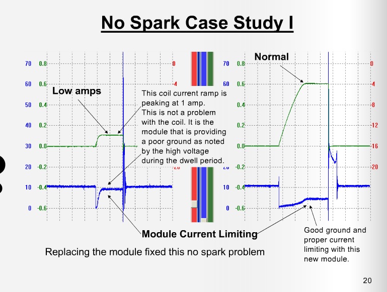

Do you have access to a scope, or low amp probe? I ask because I'd be very interested to know how much current the coil is drawing while it's making weak spark.
ScannerDanner talks about this in a couple different videos, but the idea is that the ignition module fails in such a way that it starts current limiting the coil WAY before it should be. So, instead of drawing six, eight, or ten amps like it should be, it ends up drawing one or two amps. Then you've got weak spark.
There's a great example of this in Section 22, page 20 of Engine Performance Diagnostics:
If you don't have a scope or low amp probe, then it becomes tougher to prove a failed module. Given that you've already replaced the coil, I think my next move would be to recheck power and control at the coil itself before replacing the module. I see that O'Reillys tested the module, but I wouldn't place a lot of faith in their bench tester. ;-) We know that the module is 'working', or switching ground to the coil, but may not be carrying enough load to produce strong spark.

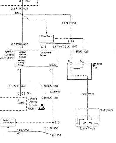

:lol: No problem. I grabbed a diagram of this system, mostly for my reference. :blush: But also for anyone else following along.
Kinda blurry, I know, but it'll work. The ground for the ICM, pin C black wire, can be checked with a test light connected to B+. Crank the engine and look for the light to go dim. Do this with the connector plugged in and backprobed. The brightness of the light will change with starter current, but should NOT go out or get dim. I believe you already checked ICM power, correct? You can recheck it if you like, same as above, with the test light connected to B-.

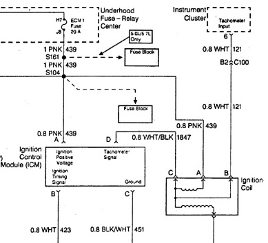

The coil control wire, pin D white/black, can also get checked with the test light, connected to B+. Connected and backprobed, the light should pulse rapidly during cranking. The 'Tachometer Signal' label on that pin is kinda confusing... It's definitely the coil control, but it's also the source of the tach signal on some models. Here's an example of how the circuit looks on a pickup with a tachometer:
Probably worth checking the coil power feed as well, pin A pink wire. Test light connected to B-, should remain lit solid during cranking. Any significant dimming or going out is a red flag.
Let me know how it goes! Please feel free to ask more questions as needed. :cheer:
