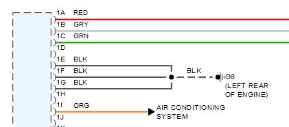

2011 Mazda 3 had front end damage and now I’m not getting any ground connection at my main relay. I checked the wire directly at the pcm no ground there either Aswell as where the harness goes into the fuse panel. My question is where does the pcm get its ground from ?
- Posts: 2223
3 years 1 month ago - 3 years 1 month ago #63135
Replied by Chad on topic No ground at PCM or at fuse panel 2011 Mazda 3 2.0l 5 speed standard n
From G6, Left rear of engine.

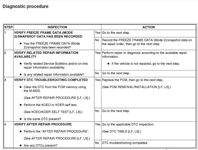

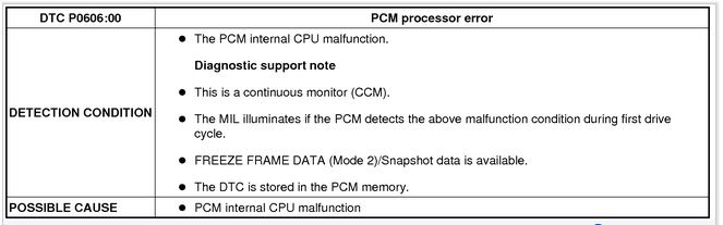

Not sure what you mean by G6. Would that cause the computer to put out the code P0606? When I ground the main relay out it will start but I get no throttle response and the codes P0606 and P2011

G6 is the name of the ground, from which the PCM is grounded. It should be bolted to the left, rear of the engine.Not sure what you mean by G6.
It is, certainly, possible. P0606 is an internal PCM malfunction. Verify that the PCM is getting GOOD power and ground.Would that cause the computer to put out the code P0606?
