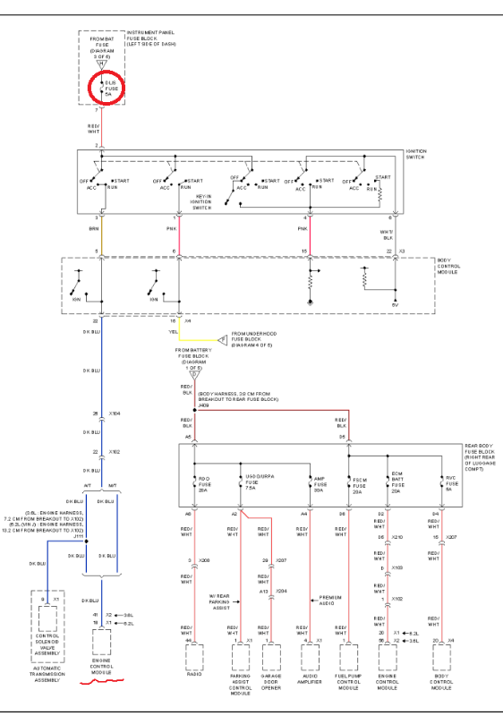

2 years 10 months ago #63216 by Gunn
Hey all, I've been watching a bunch of ScannerDanner YouTube videos to help me figure this out and have learned a lot! But not sure where to go from here. I'm fairly knowledgeable about electric circuits, use of a multimeter, etc. but reaching my diagnostic limits here on this one...
I have a 2011 Camaro 3.6l V6 LLT engine, pretty much a stock car, no modifications. Been running fine for a couple of years. Shut it off in the driveway and this past Sunday tried to start it, but nothing. Wouldn't even crank. Noticed that the check engine light was flashing quickly, like 2-3Hz. Never seen that before. Hooked up my bluetooth OBDII scanner and it shows code U0100. Also displays "Service stabilitrack" and at first, the fuel gauge was reading empty (even though I had a little over 1/2 tank).
After searching on the internet, a common cause was bad grounds. So I spent the day finding all grounds in the engine compartment (using a downloaded PDF Service Manual as reference), removing and cleaning them and then reassembling. Didn't help.

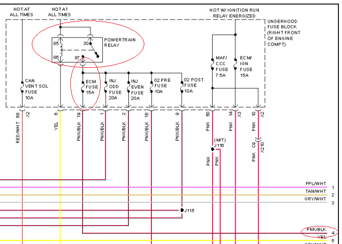

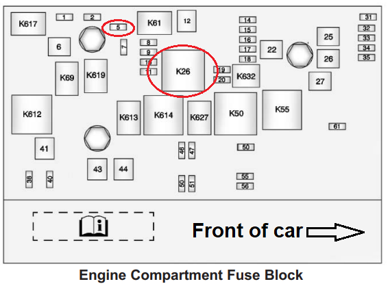

Then I moved to fuses. Sure enough, I found the #5 fuse, a 15A fuse for the ECM, was blown. When I replaced it, I noticed the check engine light was no longer flashing. And my fuel gauge was back! Turned the key to the Start position and it cranked! However, it would NOT start. Bummer. Checked the fuse. Blown again.
The wiring diagram for this fuse doesn't show much. Hot power goes from the POWERTRAIN RELAY, through the fuse and then splits into 3 (junction J110) and become Pins 3, 5 and 6 of the ECM (labeled IGN VOLT, page 340 of service manual) X2 connector (58 pin connector). Pins 1,2,4 are ground.
When I remove the X2 58-pin large connector of the ECM, the fuse does not blow. The X1 98-pin connector is still attached.
With everything back together and the fuse blown, whenever I open the driver door, I guess the car wakes up and I hear a 2-3 second series of 10-15 clicks from the fuse box in the engine compartment. However, when the fuse is new and good, I only get a single click. I think I found that the clicking was due to the POWERTRAIN RELAY, (K26). Whenever I remove it, no clicking.
  • With the #5 ECM Main fuse blown, relay K26 ticks quickly several times when door is opened (car "waking up"?).
  • With new fuse, just a single light click when door is opened. No 5Hz clicking.
  • With new fuse installed, no voltage on ECM fuse #5 is measured with car asleep, key off.
  • With car awake (open the driver door), installed fuse now shows 12.8V on left side leg (towards rear of car).
  • Right side of fuse shows basically 0V...?! I don't get this...bad measurement or probe access? But continuity check is fine with same probes.
  • ~90seconds later, a click is heard (relay) and fuse blows
  • With fuse blown each side measure 0 volts to ground with door immediately opened (car awake). Shouldn't I get voltage on the power side of the leg?
I have learned that the key position makes no difference. It's whether the car is awake or asleep. All o f these tests are with the key off. And it seems to blow the fuse at the point it decides to go to sleep, strange!
The relay tested out fine on the bench. 80ohms across the control terminals, and with 12V applied across control terminals, relay clicks and continuity is confirmed on load terminals. I even swapped the K26 fuse with the K55 fuse (rear defogger). Same issue, so I'm pretty certain the relay is OK.
Unsure where to go from here!

If the diagram you posted is not omitting anything, then it appears as that fuse feeds the PCM with nonstops in between.
Because it branches intoultiple circuits, makes me think the circuit is not purely for powering on the computer, but is probably distributed by the PCM for outputs (just my initial thought, I've been wrong before), so disconnectimg the PCM doesn't necessarily eliminate an output in my eyes just yet.
I would probably start with a wiggle test of the harness. Meter on ohms, one lead in the circuit, one to ground, handle the harness around pinch points or chaffing areas and look for continuity to ground, ie: a short.
"With car awake (open the driver door), installed fuse now shows 12.8V on left side leg (towards rear of car).
Right side of fuse shows basically 0V.."
If the fuse is removed this normal. Ov is the side going to the component, the 12v is the side going to the battery.
If the fuse is installed, this is a bad fuse.

So I concentrated on the diagram attached and the Powertrain Relay, the 15A ECM fuse that keeps blowing, and the wiring to the ECM. The PNK/BLK wire eventually splits into 3 PNK/BLK wires and go into Pins 3, 5, 6 of the X2 Connector on the ECM.
I wanted to test if the wiring from the fuse box to the ECM connector had the short or not. I kinda was hoping it di as it's pretty short and right in the area of the fusebox in the engine compartment. But I couldn't energize the Powertrain relay without the fuse blowing.
I removed the X2 connector from the ECM. And I removed the relay and verified I had 12V battery power on 30 and 85 of the relay connectors in the fuse box. I then put in a jumper wire from 30 to 87. When I did this, the "left" leg (towards rear of car as looking from passenger fender) of the ECM fuse had 12V power. Cool, now I could check that harness to the ECM pins.
I checked for a short in that harness using an ohmmeter but didn't detect anything (as I learned how to do from ScannerDanner Youtube videos!). So then I put in a new 15A fuse and crossed my fingers (actually hoping it would blow!). It didn't. It was fine. I then measured 12V power on pins 3, 5, 6 of the ECM x2 connector. I also checked for ground on pins 1,2 and 4 which did have a good ground. So those first 6 pins are all fine.
So that means the harness pertaining to that ECM fuse from battery, through fuse box, to the ECM is just fine.

2 years 10 months ago - 2 years 10 months ago #63240 by 70monte
In order to power up the relay that controls that fuse and to cause it to blow, pin 86 of the relay has to be grounded. The relay is powered all of the time through pins 30 and 85. Your wiring diagram doesn't show what is grounding the relay on pin 86. I'm assuming it's probably going to be the ECM.
If your diagram is accurate and nothing else is on that circuit, there has to be a short to ground on the wiring from the battery to the relay, from the relay to the ECM, or an internal short in the ECM itself.
It doesn't really make sense that opening the door would ground pin 86 of the relay and give that entire circuit power so that the short occurs.  I would think that opening the door would wake up the BCM instead of the ECM.  I guess waking up the BCM could also wake up the ECM and if the ECM is shorted internally, it could then provide the ground to pin 86 of the relay and power up that circuit and then short it out.  I guess it's hard to tell unless you know how that whole system works.
Maybe get a one day subscription to Alldata DIY and see if it has better wiring diagrams to see if there are other things on that circuit other than what your wiring diagram shows.

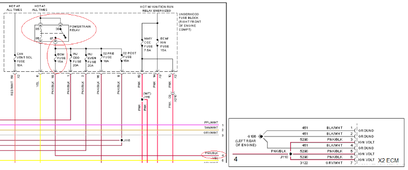

Yes, you are right. Pin 85 and Pin 30 of the relay do show a good battery voltage, so all is good upstream to the battery at that point.
Ping 85 (yellow wire out of fuse box) goes to pin 58 of the ECM, the last pin on the X2 connector.

2 years 10 months ago - 2 years 10 months ago #63272 by Gunn
Alright, thanks for the all the comments and suggestions guys. I've been able to get out to the car and mess with it a bit more. More clues, but still no fix.
I've looked at the driver and passenger door wiring but it all looks very nice and clean. Plus, the driver door window, locks and trunk release all work. So I don't think there's a problem there.
I can't check for a 5V reference on any sensors since the ECM won't power up! Once the ECM tries to come alive via the powertrain relay and that 15A ECM Fuse, it immediately blows.
Since the powertrain relay is trying to energize the ECM when I either open the door or put the key into the ignition, I decided to go mess with the BCM circuitry and fuses based on some suggestions. First I removed ALL fuses, circuit breakers and relays from the Instrument Panel Fuse Block (driver side dash).
Put in a new 15A ECM fuse, all good. But of course, the car is basically dead. No power anywhere. In looking at the fuse diagram, there are fuses labeled BCM 1 - 8. BCM6 is in the underhood fuse box and is still there and is fine.
I figured those fuses should go back in first since all of the other accessory stuff probably wouldn't even work without them. So I started with "BCM 1" in position F25. Boom. The fuse immediately blew (I had the door open). Well that was fast. I removed it, replaced the ECM fuse and then was able to add BCM 2, 3, 4, 5, 7, 8 all without any problems. I re-added the relays and circuit breakers, no problem. At this point I decided to add in the rest of the accessory fuses (without F25, BCM1).

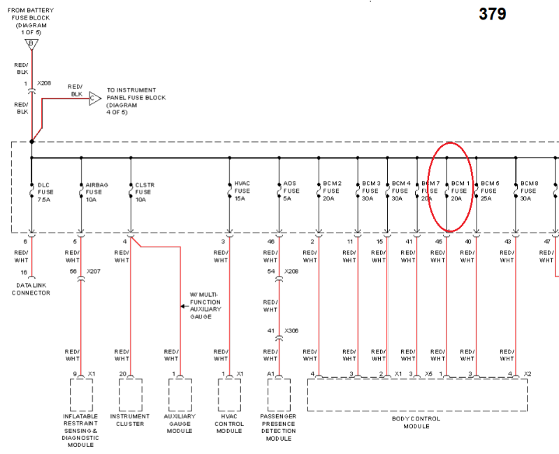

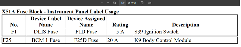

When I got to the very last one, F1 DLIS fuse ("Discrete Logic Ignition Switch"), a 5A fuse, boom! It blew again. I removed ALL of the fuses again, replaced the ECM fuse that blew in the engine compartment and then just added F1. Boom, it blew.
Bottom line, if ALL fuses are out and I add EITHER F1 DLIS or F25 BCM1, the ECM fuse blows.
I came back in, poured over the wiring diagrams but really couldn't find any real link. Obviously, either of these two fuses is triggering the ECM to ground out pin 86 on the powertrain relay (yellow wire, pin 58 of the ECM X2 connector) on the trigger side, which then tries to energize the load side containing the ECM fuse, which is then shorting out to ground. So I don't know how much help this is, since my issue must still be in that load side, of which the wiring diagrams show the wires ending up in the ECM (and I've proven the harness from fuse box to ECM is good for these wires in my previous post).
Attached are some wiring diagrams I found of these two fuses. I can't see anything helpful. I hope someone else can!

2 years 10 months ago - 2 years 10 months ago #63273 by 70monte
To rule out the wiring going from the powertrain relay to the ECM, disconnect the X2 connector at the ECM and give pin 86 of the powertrain relay a ground from the negative side of the battery. You can back probe pin 58 at the ECM harness or use a piercing probe on the yellow wire that goes to it. You will be basically doing the job that the ECM is supposed to do by grounding out that pin. If the ECM fuse doesn't blow, then you know that the wiring going to the ECM is good. You can then remove your provided ground on pin 86 and plug back in the ECM and disconnect the harness at the BCM that comes from the ECM and just use the key to turn the power back on to see if the ECM fuse blows with the BCM isolated from the ECM. If it doesn't blow with the BCM unplugged, then your problem is either in the wiring from the ECM to the BCM or the BCM itself.  If the ECM fuse still blows with the BCM isolated from it then the problem is in the ECM.
Last edit: 2 years 10 months ago by 70monte.

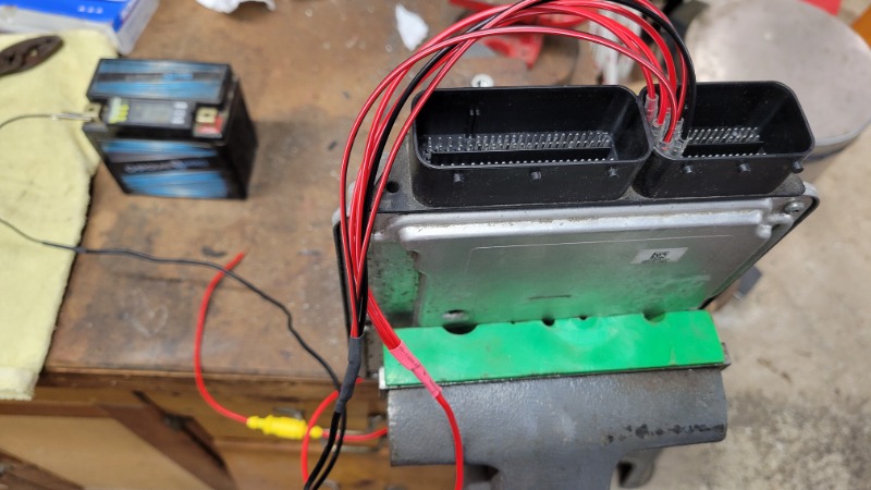

2 years 10 months ago - 2 years 10 months ago #63344 by Gunn
FINALLY, Progress!!
As I mentioned previously I removed the ECM and took it to the workbench. I created a small power wiring harness with three wires to apply +12V power to the power pins (3, 5, 6) and three wires to apply ground to the ground pins (1, 2, 4) in the X2 ECM connector. Small crimp spade terminals that I had to pry open just a bit worked perfectly on the ECM terminals.
I added an inline fuse holder and a 15A fuse. Sure enough the second I touched the positive wire to the red terminal of the 12V battery, I heard a faint click in the ECM and then the fuse promptly blew! I tried it again for good measure; same result.
So now I have definitively proven the ECM is responsible for the short-to-ground within it. I had already proven the wiring harness for these 3 positive PNK/BLK wires from the load side of the fuse to the ECM pins was good with no shorts.
I have the ECM boxed up and ready to ship today to Module Experts. They'll do a lifetime warranty repair with a three business day turnaround. With my shipping cost to them included, it's just a bit under $200 total.
I'm sure I'll still be anxiety-ridden when I plug it back into the car, but I feel pretty confident I've found the problem...one of the lucky (unlucky?) ones with an actual ECM problem! Trust the wiring diagram. It showed me the complete circuit I was dealing with.
Thanks for the tips, help and suggestions, I'll update as soon as I get the ECM back and see what happens.
Tom
(And in the pic below, the 3 ground wires are indeed mostly black, though it doesn't appear to look that way in this photo! They were a red/black wire combo that I separated).
