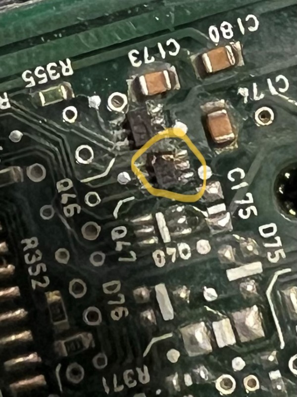

4) Replaced ECU with one from junkyard due to the transistor that fires the coil being melted (i have a picture if anyone wants to see) and putting 5v to one of the coils all the time, the new ECU has the wrong VIN, but my bidirectional Launch X431 doesn't have an option to change the VIN on this car., i am not sure if this effects anything on this old a model. I called the dealership and they basically said unless i bought a new ECU from them there was nothing they could do.

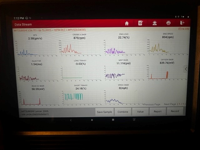

Short term fuel trim stays around 24% for the most part (see screenshot from the launch), Long term has been staying -0.03%, O2 sensor bank 1 reads around 0 a lot of the time and bank 2 reads 0 a lot of the time also, i can raise the O2 sensor by spraying starting fluid into the intake while the car is running.

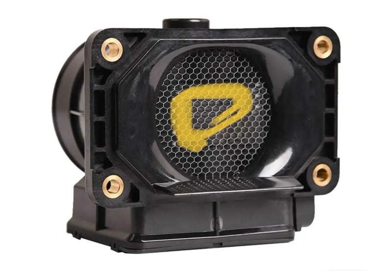

Cleaned MAF with the proper cleaner, sprayed carb cleaner it all around the intake and nothing made the car surge or raise the o2 readings (no air leak after the MAF I could find)
