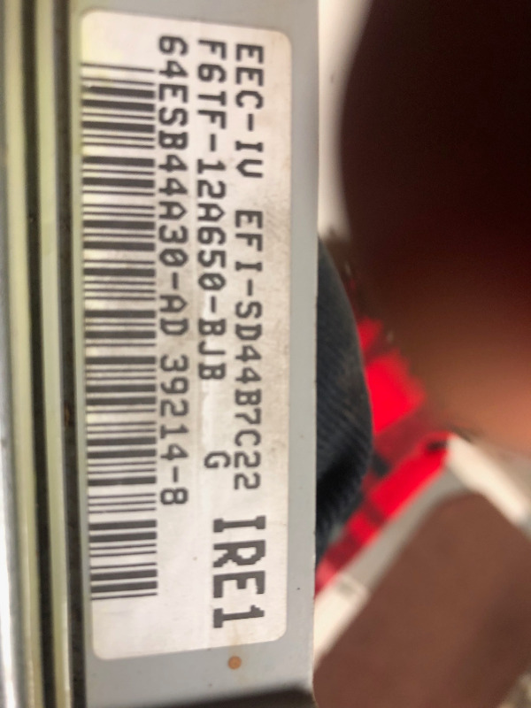

We swapped out the ECM with a rebuilt one (I had bought it as a backup after the original one went bad a year ago and I had to replace it), as well as the smaller module on the fire wall - which was also brand new... neither had any effect.
The engine cranks great ... it just will not catch.
He's showed me that their was power going to the coil, but the side going to the 'engine?' was not pulsing. So he thinks its the distributor.  He said the text light he had on the engine side of the coal should be flashing 10+ times a second, but it was a sold light, just like the other side of the coil.
I'm not sure what this means, but when I crank the engine, the Tach on the instrument cluster does not move off of zero.

My mechanic put in a new distributor - still no start.
While we were talking, we both realized that the neither of us heard either of the fuel pumps (I have two tanks) - and checked, and they are not getting power as well,.
There is also no power to the ignition module... and there is no 'connection' between the stator in the distributor and the coil
