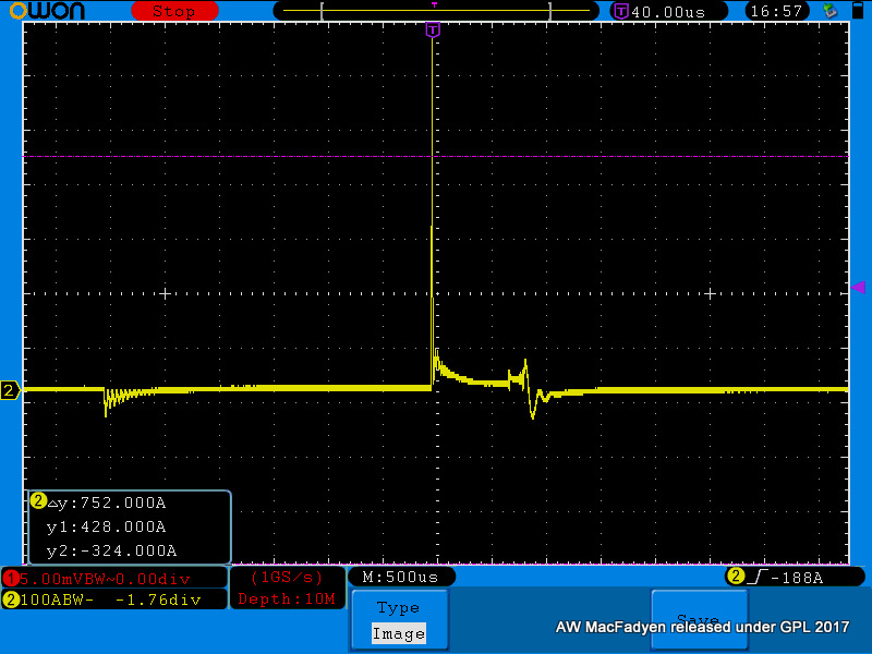

9 years 4 months ago - 9 years 4 months ago #10760 by Andy.MacFadyen
Replied by Andy.MacFadyen on topic GM HEI ignition waveforms
I discovered by accident that on some ignition systems you can capture primary waveforms by holding the scope + lead in one hand ( - to block ground) and simply holding other hand over but not actually touching a COP coil.
Edit I was using the scope this morning so I did a quick capture using above method ---
Last edit: 9 years 4 months ago by Andy.MacFadyen.
9 years 4 months ago #10761 by Ben
Replied by Ben on topic Re:GM HEI ignition waveforms
That's interesting Andy! this is taken with pos lead in 1 hand and other hand near a cop? What voltage setting are you on?
