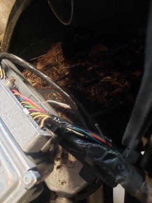

I thought I would post a follow up even though its not related to my original question because it was an interesting one. This was the cause of the fault. It appears a critter had gotten into the air box and chewed the reference wire for the EGR position sensor. Very strange that that was the only wire he seems to have gotten to by the time he got through the tape.

2 years 11 months ago #63469
Replied by Noah on topic Buick Century EGR operation question
Thank you for the follow up.
I always wonder when I find one wire chaffed through or chewed up, "what are the odds it was THAT circuit?".
We use peppermint to discourage rodent activity on limousines that are put down for any period of time.
If nothing else, at least it smells better than squirrel piss alone
