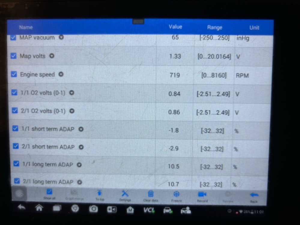

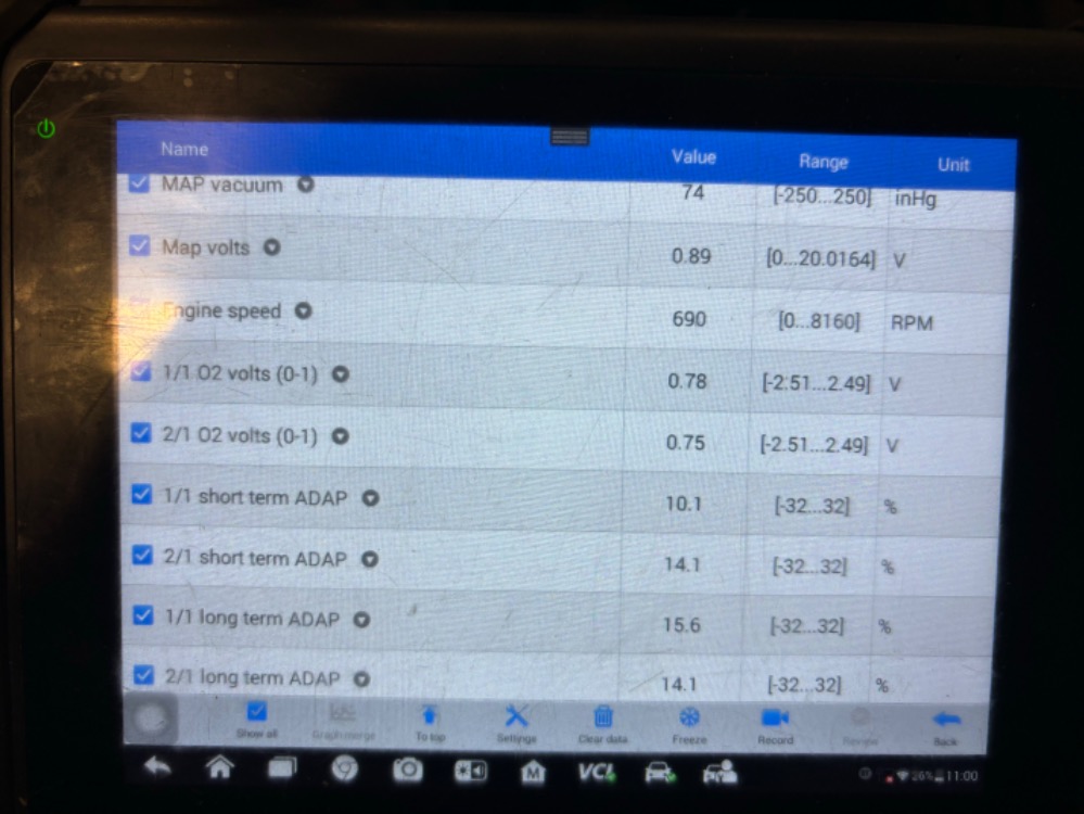

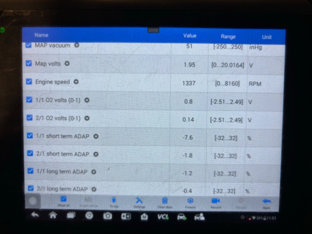

2 years 7 months ago - 2 years 7 months ago #64958 by fbbt12
Some live data
1. near 1500 RPM with load - transmission in D holding brakes
2. Idling with load - transmission in D holding brakes
3. Idling without load
Last edit: 2 years 7 months ago by fbbt12.
