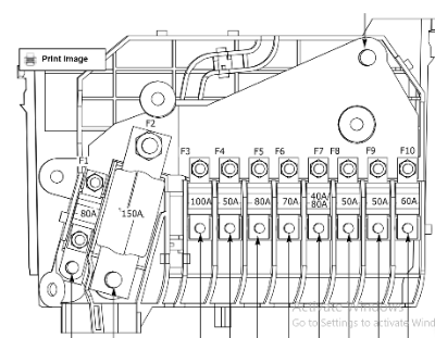

2 years 11 months ago - 2 years 11 months ago #63547 by Rachelre39
2015 Ford Transit Connect XLT Eco Boost 1.6 litre..
The battery died because seat warmer was left plugged in.
Used 48 volt scooter battery to charge the 12v. The area by the fuse box under the dash and/or radio puffed smoke and upon examination many fuses were blown.  Before the car stopped cranking and starting the driver side window went down by itself and it wont go up. I also blew up the battery so i bought a new one after i got paid along with fuses.  The drivers side window still wont go up the car will not start or crank power and lights work. It is not a relay or fuse that I can tell as I conducted continuity tests.  My dad said something about a fusable link...
i was hoping someone could poiny me in right direction need car to get to work..
the radio and drivers side window does not work the car wont crank wont start but the passenger drivers side window does work..
please advise
sincerely,
Rachel
Last edit: 2 years 11 months ago by Rachelre39. Reason: Title
2 years 11 months ago #63550 by Tyler
Replied by Tyler on topic No start or crank mystery
Rachel, are you in the US, or overseas? Need to know for potential wiring differences between US market and others.
I see that you've already replaced some fuses, and tested others, but I'd still say a good first step is to start over at the battery and work your way down. Continuity is good, but what we really need is voltage testing. Start at the high current battery junction box and then move to the battery junction box:
We want to know which fuses have power on both sides (good), which fuses have power on one side (blown) and which fuses don't have power on either side (might be OK, might be a problem).

2 years 11 months ago #63604 by stevieturbo
Replied by stevieturbo on topic No start or crank mystery
Are you saying you hooked up 48v to the cars 12v system ???
Really can't see that ending well.
Do you have any comms with the ecu, or signs of life from it ?

2 years 11 months ago #63608 by stevieturbo
I repeat again.
So you hooked up 48v to the cars 12v system ? Crazy thing to do
Have you tested that the ecu itself has power ?
Really, there is a good chance you've killed lots of modules within the car, and this will not be an easy DIY fix without good wiring knowledge and ability to test modules.
