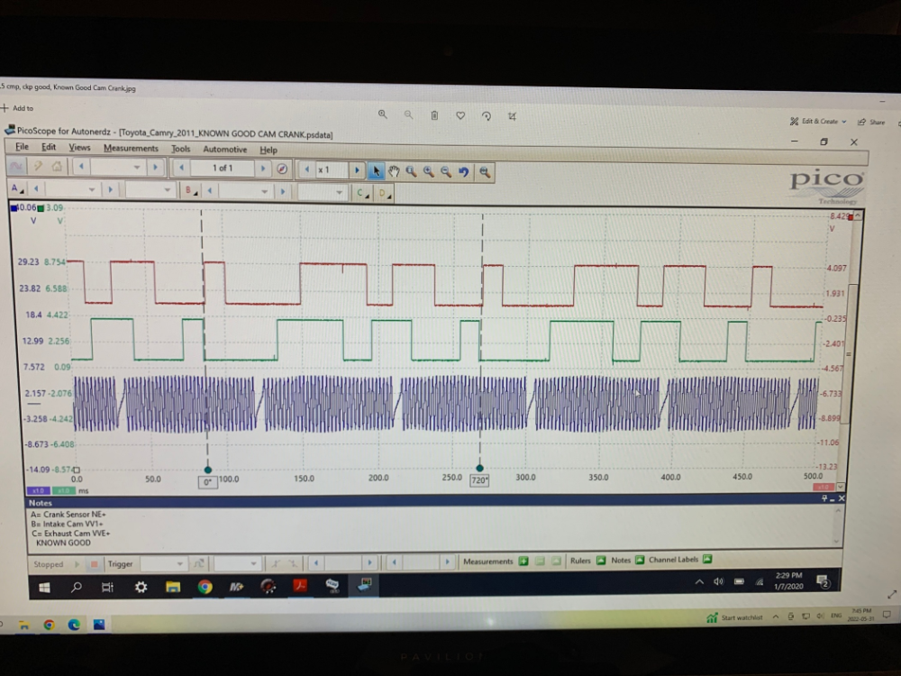

Hello guys , I have been working on a 2011 Toyota Camry 2.5 with intermittent stalling issue . it kept throwing codep0015 and also p0017cam and crank shaft code I did everything  to fixed that issue no luck yet I replaced the camshaft sensors also the crank sensor , mass airflow sensor with dealer part I cleaned the throttle body after that I erased the code  the car would drive fine until I reach a red  light or making a turn then it would stall again and the same code would come back . Before I decided to replace the timing chain , I am here searching for help to see what else I have to do any advice would greatly appreciate thank you.

So a couple of things to go with the performance timing codes:
- VVTS faulty
-Oil Control Solenoids faulty
-Not enough Oil pressure at Oil Solenoids to operate VVT properly
-Timing chains is out of time
With proper tooling VVT can be checked against desired positions and actual positions
The Chain timing can be compared to a known good Correlation which I am providing.
Known Good;
Also, here is an excellent video from Ivan at Pine Hollow Auto Diagnostics showing what is necessary to prove problems like this out.
I hope you kept all the original sensors, they are Denso's, very good quality!
Never stop Learning.
