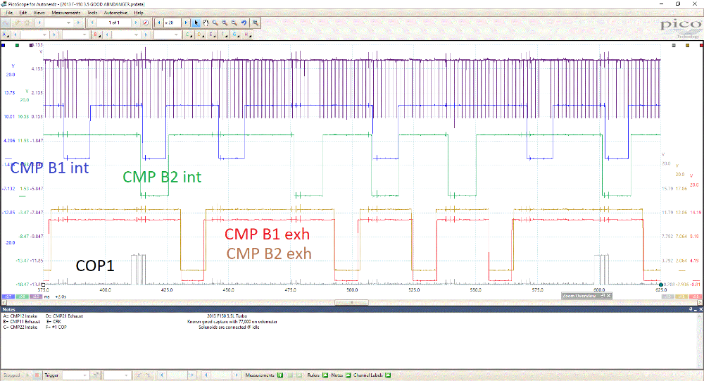

Yes that is very possible, all it takes is a chain tensioner to collapse and you're out of time.
Sounds like you're also dealing with cylinder wash.
Any Codes?
Now is a good time to break out the Scope for your students and perform a Cam Crank Correlation, here is a known good.
Any Codes?

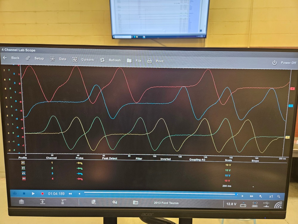

So I don't know why we are getting this type of pattern. We just got this snap on scope and still trying to navigate it.

Interesting, You're capture of the four cams is the older style 3.5 engine.
I do not have a known good, but I do recall the waveforms nestle right into each other, your yellow and red overlay at a hump and so do the other 2, However, are they correct to the CKP?
It's been a few days, what other testing have you performed?

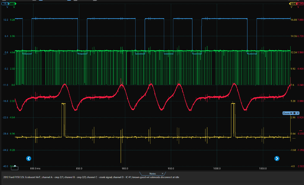

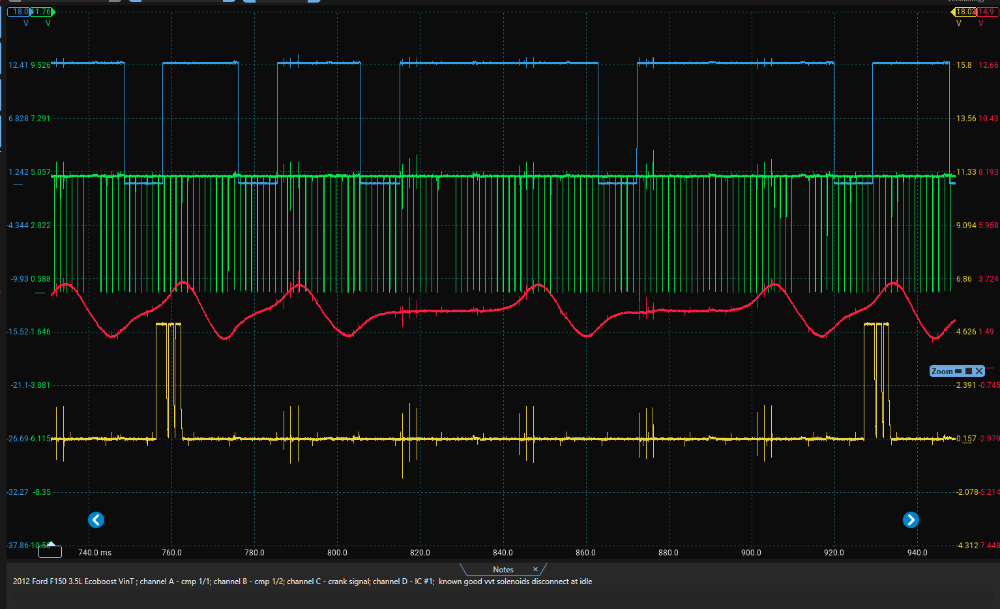

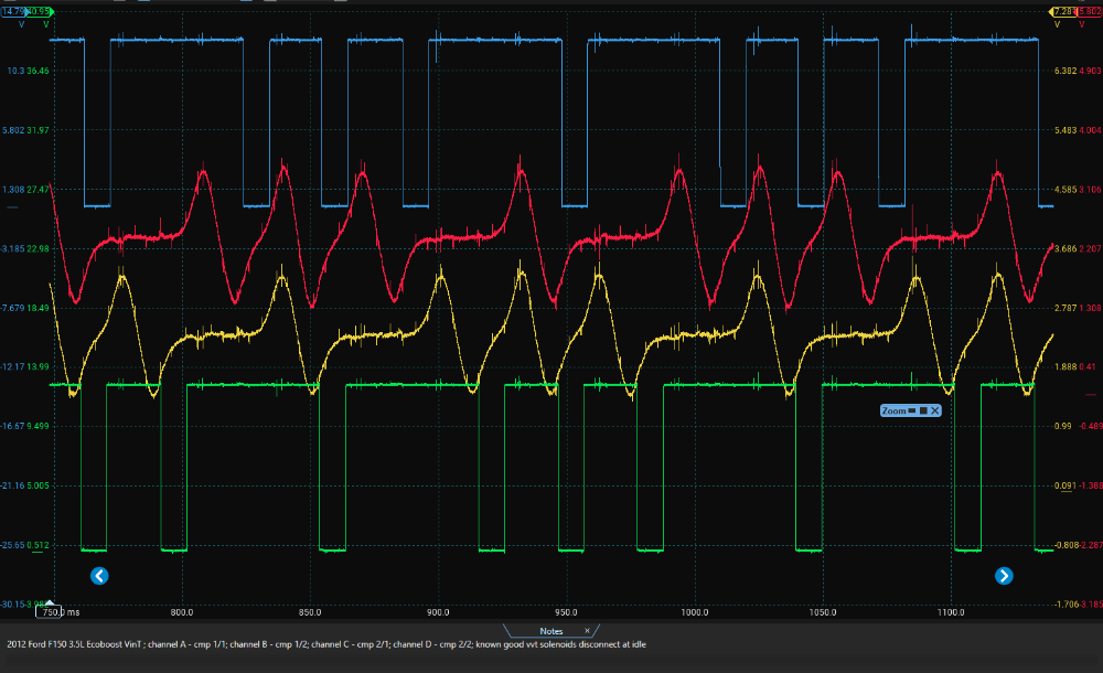

Here is, yet, another 3.5L variation. This is a 2012... Vin T
If the only thing that they changed was the type of sensor, maybe these can help.
All Cams
Bank 1
Bank 2
All Cams
Bank 1
Bank 2

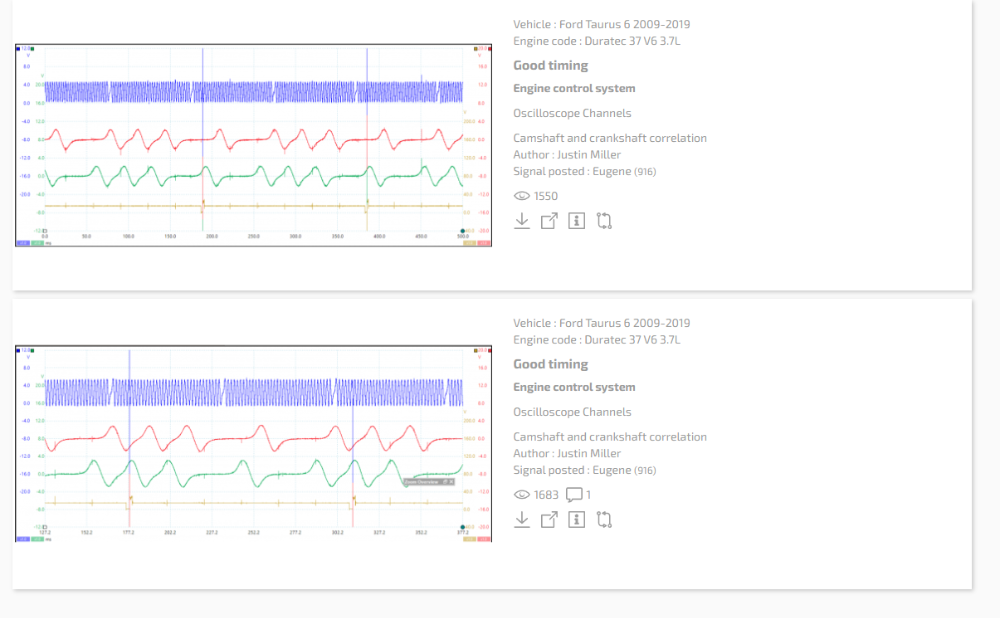

You are positive it is not a 3.7l engine? The 3.7 seems to fearure 4 VR cam sensors.....
You'll find the caputers on the rotkee waveform library if you want to play with them
