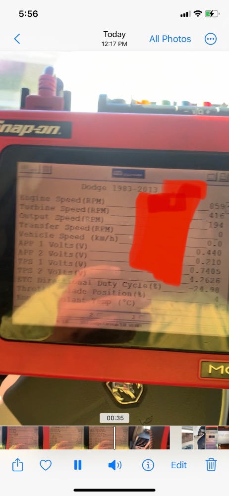

2 years 11 months ago #63594 by Tonymac
  Hello I have a 2009 dodge caravan 3.8 with a 62te transmission was first getting code p1790 and p0731 sent the transmission to get rebuilt and I installed it now I’m getting just the p0731 .I check the output speed sensor has rpm movement also engine rpm and turbine rpm also have movement but the transfer speed sensor shows 0 movement on the transmission live data .I back probed the pcm connector and the wave form was showing good signal. Any thoughts would be greatly appreciate ,thanks in advance
2 years 8 months ago #64779 by TonyMac82
Replied by TonyMac82 on topic 62te transmission code731 after rebuild
Figured it out the transfer speed sensor was sending a weak signal replaced it and works great scan data shows good activity
