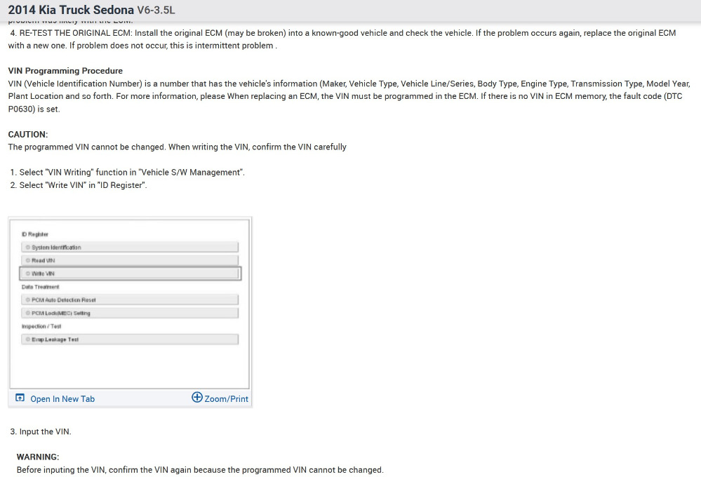

Question for a Kia tech with Autel scan tool (I have an MP808 variant).  After significant diagnostics I have concluded the PCM is bad and needs replaced as it is not controlling the VCMA nor will the scantool control it properly when used.  Powers, Ground, and Circuit integrity have all been check, as well as proper pin location in terminal blocks both at VCMA and PCM. The owner of the vehicle wants to use a Salvage yard PCM.  I did some digging in the scantool and see there is a write vin capability (or at least a menu selection).  I do a lot of diagnostics, but not a lot of programming/module replacement as it is a side job for me and I don't make the income required to purchase a lot of the high dollar programming equipment.  So my question is, will simply getting a matching PCM from a salvage yard and doing a VIN change (if the tool can actually do it - I know better than to just assume it can) all that needs to be done to get the customer back on the road, or should I advise him to take it somewhere else to have the procedure done (if it's outside the scope of my limited equipment).
It is likely that this will, only, work with NEW module.
It may require the EEPROM being swapped/cloned, to use a used module.

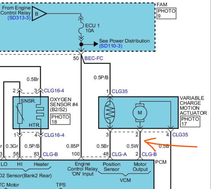

So with KOEO on and with the harness plugged into the VCMA I have (via backprobe pins):
PIN #1 - 12V (11.59)  (SIDE NOTE:  I have powered a (incandescent) test light from this circuit to battery ground & checked for proper pin location @ PCM)
PIN #2 - when jumpering/applying 12V+ from pin #1 to this pin I have ZERO movement on the actuator.
(for reference, the VCMA is NOT installed/connected to the intake I have it out facing up so I can see if the arm moves.)
PIN #3 - did not check this pin today (but I know pins #2 & #3 both have continuity from harness plug back to proper pins at the PCM.)
PIN #4 - GND  (SIDE NOTE:  I have powered a (incandescent) test light from this circuit to battery positive & checked for proper pin location @ PCM)
NOTE:
NEW (parts store) VCMA does the same thing as the current one when plugged in (all though I did not jumper pin #1 to pin #2 on the new one - oversight on my part).
Vehicle recently had engine swap and a brand new lower intake (with the flaps/sensor) installed (not by me).  (vehicle runs fine (don't suspect an engine issue) just has these codes that customer wants fixed)
I also tried unpluging the VCM Sensor (goes to lower intake) to ensure there wasn't any issue with it bringing the circuit down (hail Mary move)
I even disassembled the VCMA (fairly easy to take apart - wasn't sealed with glue like the new one was) and verified with a 9v battery hooked directly to motor that motor is good (motor was isolated from VCMA circuitry)  also verified the arm pivoted freely with the motor removed (not seized).  internal circuit board looked good, did not see any indication of heat damage, or faulty circuit components.

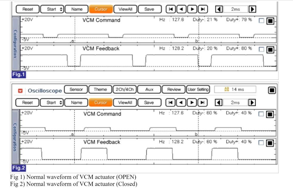

I did a little digging in SI on the fault codes you posted. The only one that came up with anything was P200A. None of the other faults were listed in SI... Not sure if SI is lying or the scan tool/vehicle is.
Anyway, the P200A info was nice enough to show some known good examples of the VCMA control signals, open and closed:
I know that it's a little bit late now that the vehicle is gone. But if you happen to see this one again, I figure a DMM would work to measure voltage and duty cycle on on pin #2 and #3 at the VCMA. Scope would be nice, but not required.

Nice, and thank-you, if I get it back I will definitely do some more...wonder if I can get close with DMM on Frequency or duty cycle to read the signal....hmmm.
