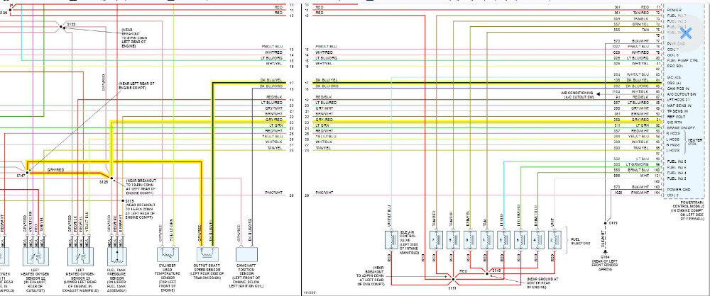

I am currently working on a 2000 Mercury Grand Marquis LS with 142000 miles. It originally came to me with a P0720, P0722. & P0503 DTCs. I checked continuity on the wiring harness from both the VSS and OSS all the way to the pins on the PCM and have less than1 ohm on all wires. I did notice that I would get a random M ohm readings when accidentally probing the wrong PCM connector terminal, but I had not unplugged all sensors that the harness was connected to so I'm not sure if that is normal or does this indicate a possible short somewhere in the harness? Following the wiring diagram I have also removed and cleaned all pertinent grounds. After initially clearing the codes now I only get P0720 & P0722 returning after driving the car a few miles each time I clear the codes.

Do you have an OSS pid, in scan data? The OSS is a sensor that will generate its own AC voltage. It should be an AC sine-wave that increases in frequency and amplitude with speed. The preferred way to view this signal, other than a scan data pid, would be an oscilloscope. A DVOM can be used, as well.
According to SI, OSS resistance should be 334-759 Ω. Disconnect the sensor and check the resistance between the two pins of the sensor.
The Gray/Red wire is a sensor ground that is shared with many other sensors. The Dark Blue/Yellow wire is the OSS signal.
With the sensor disconnected, disconnect the PCM connector. Check for continuity between the Dark Blue/Yellow signal wire and the Gray/Red sensor ground wire. There should be none.
Check the continuity of the Dark Blue/Yellow signal wire, from end-to-end (PCM connector--->Sensor connector). Resistance should be less than 4Ω. If you have no continuity, OL MΩ, then the wire is broken. If resistance is less than 4 Ω, then you can conclude that the wire is not completely broken, however, it does not mean that the wire is good. You should verify that the wire can carry a load by using it to power an incandescent test-light. Test the Gray/Red ground wire the same way.
Leave the PCM disconnected, but re-connect the OSS. Check continuity between PCM connector Pins 84 and 91. Resistance should be within the specs of the OSS sensor, 334-759 Ω.

Thank you for getting back to me. I have actually ran a new wire from the OSS to the PCM to replace the blue/yellow wire. Also when probing all sensor connectors that share the Gray/red wire for opens and /or shorts I found that the left downstream O2 sensor had a slight short to ground.(5M ohm). I didn’t think it should have that reading. After replacing that O2 sensor the problem went away for a much longer time.
