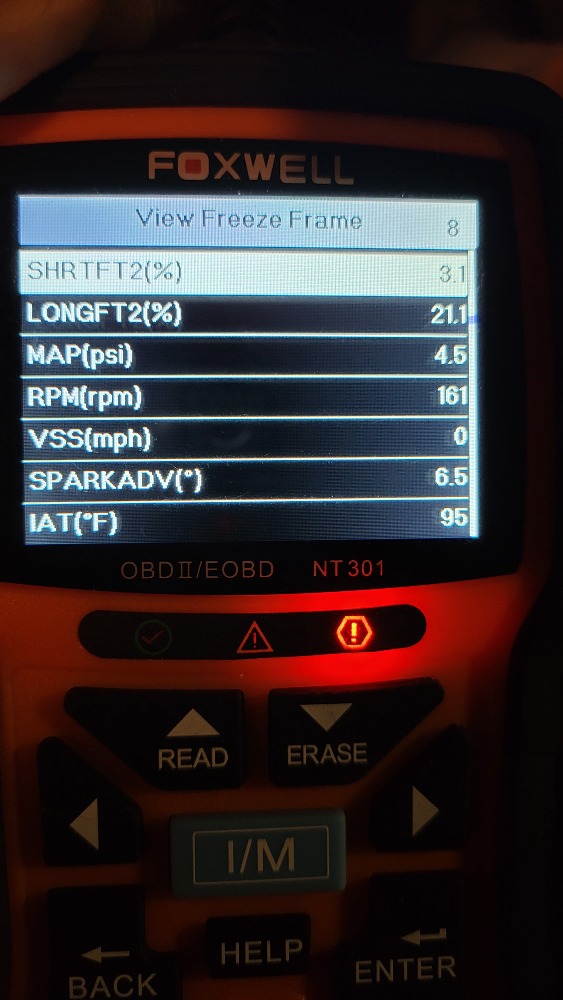

Thanks Tyler. Btw, I was just reviewing the freeze frame data from the last P0300 triggered. My scanner reports RPM at 161! This isnt right as I was sitting in it idling at the time. I pulled out an old scanner (Foxwell) and checked FF with that and same thing, 161RPM.
I looked at my older data and see RPMs low several times when P0300 was triggered. Could this be an anomaly or a clue?

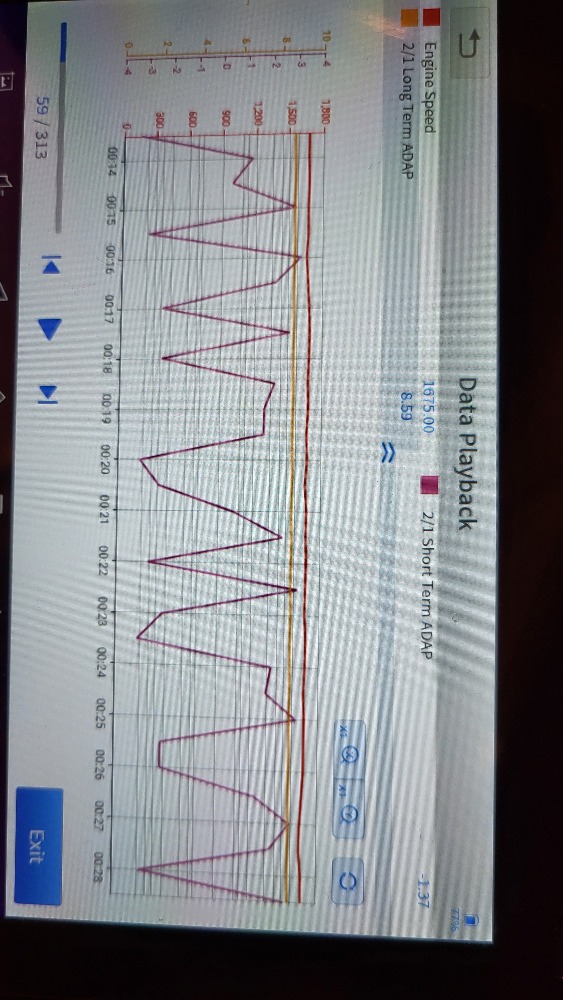

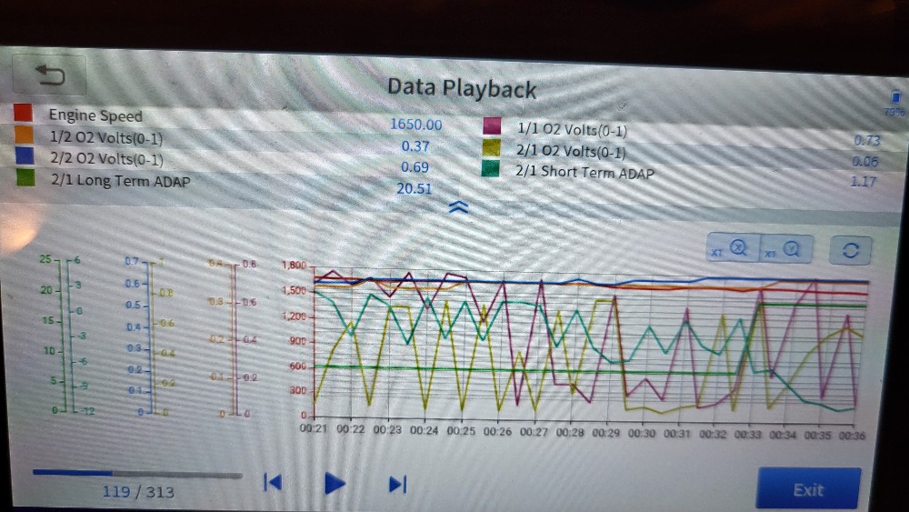

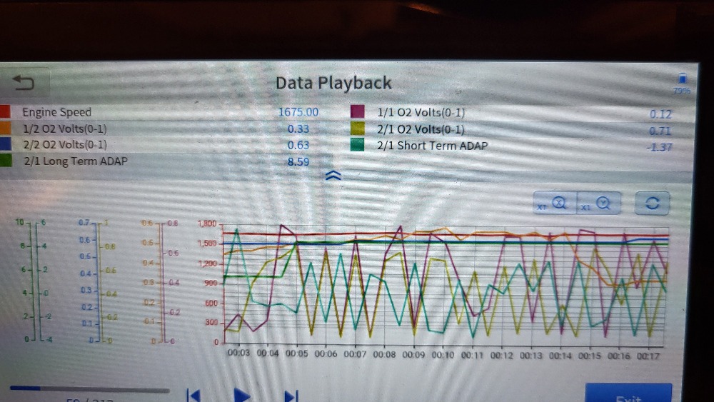

Couple of pics related to the details. First pic shows the FF date when P0300 triggered last time on old Foxwell scanner.(161rpm)
Next few pics are of a recording taken while driving around steady.
notice the big jump in LTFT between readings taken at similar rpms and road speed on the flat.
Last pic is same drive, showing just rpms and B2 ft's.
Is any other data likely to provide any more clues for u guys? Thanks again Tyler and anyone else who gets sucked into this thread
