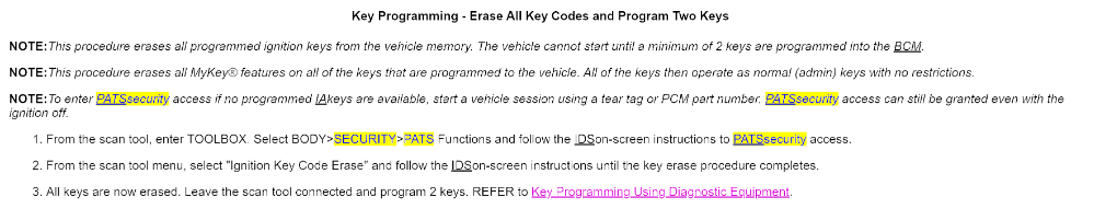

I looked into what service info says to do in this situation, and I found this:
The third note is the relevant bit. Basically, there's still a way to gain security access through IDS (or probably FJDS, too). You could look up the tear tag or PCM part number through motorcraftservice.com.
As a last chance, you could always try Forscan. It'll do PATS programming, as well as allow you to start a session based on the PCM part number. I can't say I've ever tried using it in this context, but it could be worth a shot.
