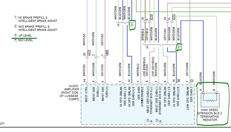

Here is the network schematic for the 2017 CTS.
Total network resistance should be 60 Ω....two 120 Ω resistor, in parallel.
>   120 Ω + 120 Ω = 60 Ω   (One resistor at each end of the network)
As Noah pointed out, you are missing a terminating resistor. The schematics are for multiple option packages. You must decipher the schematic to match what you have. For example:
Here,  a "3" corresponds to the "up level" package, and one of the terminating resistors is an external resistor.

Precise Schematic VERY HELPFUL!
Great to know that the resistor is external, which means it was mostly cut out of the circuit and also means I can get one and add it back.
I will locate the circuit that appears to be near the Harmon Kardon/Onstar device and report back after 4 pm CST.

I wasn't sure where the other terminating resistor was located and now that I cut the pre-crimped High/Low loop it went back to infinity but able to see voltage on both High/Low with no resistance. Curious why it is short to group when that junction is crimped. I did disconnect the Harmon/Onstar module but still was getting a short to ground. I am afraid even after adding the second external 120ohm resistor there still will be that short to ground if I reconnect that junction how it was.
