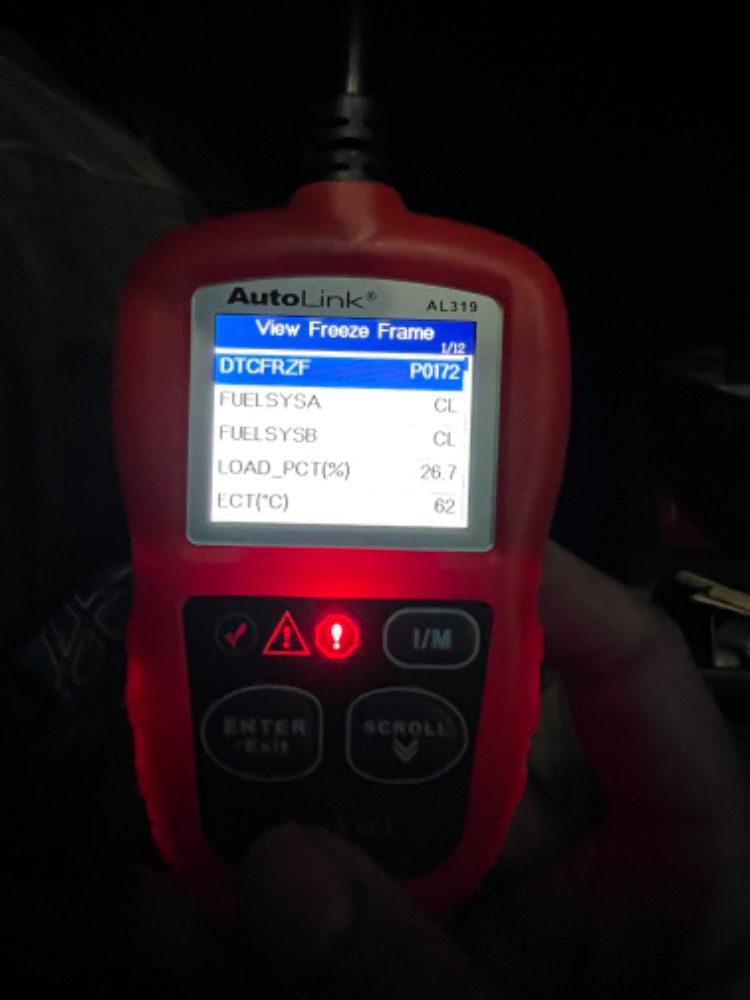

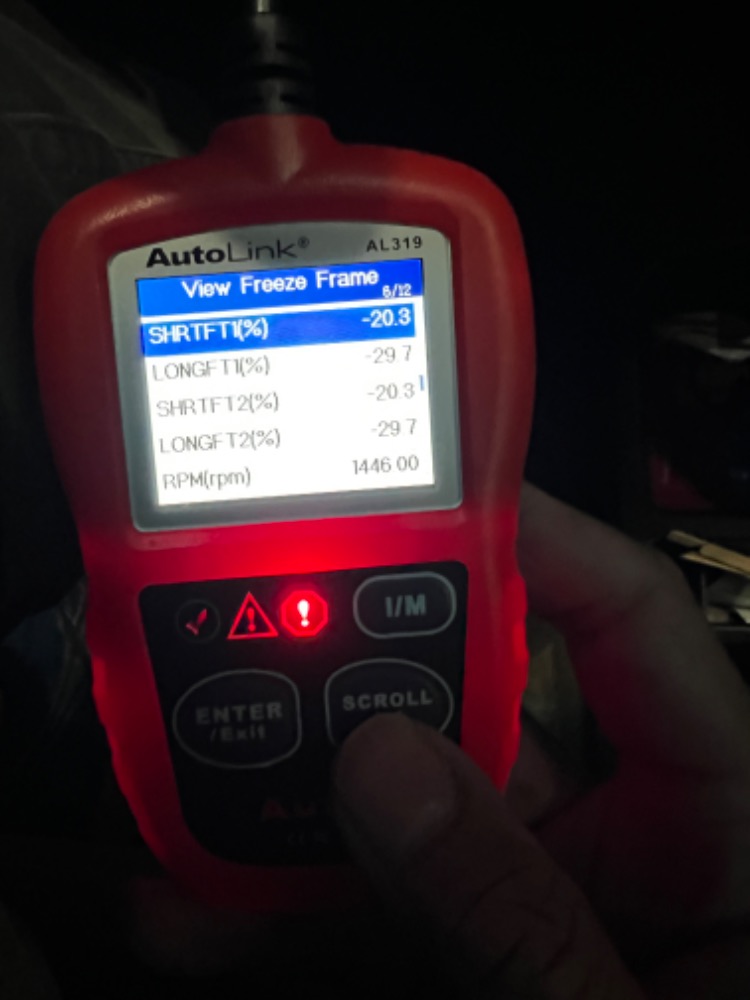

Holy negative fuel trims in that Freeze Frame.
Given how both banks are equally negative, I think it's safe to say there's something impacting both banks.

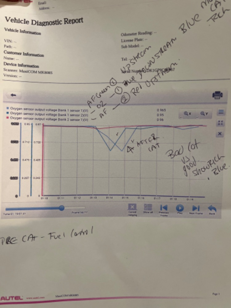

I know you replaced the MAF, but I'd still suggest checking its readings anyway. At hot idle with no loads on, we generally expect the MAF rate in g/s to equal engine displacement. In this case, 3.0 g/s.
I'd also suggest watching the O2 signal and trims while the engine is warming up from a cold start. I see you've got a capture from an Autel, but again, I'd suggest doing your own oxygen sensor testing. With the engine at a hot idle, create a large vacuum leak and make sure all three O2 respond quickly. Add brake cleaner to the same vacuum leak and look again.

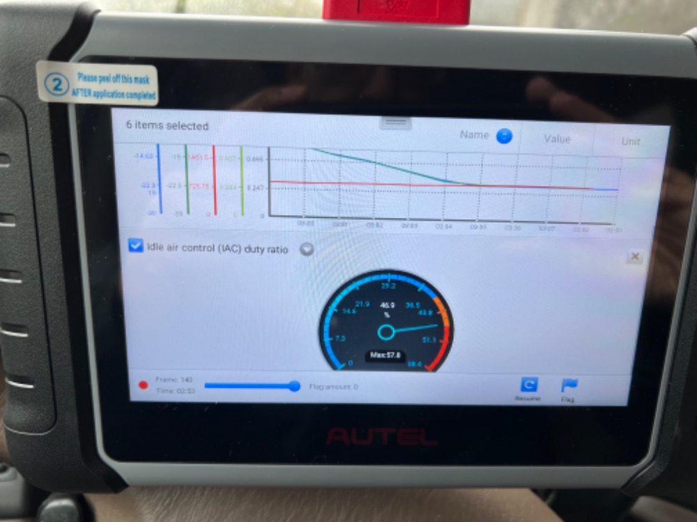

MAF is between 5-8 on startup then settles down to between 3 and 4
O2/AF sensors don’t seem to react to rich conditions or lean when I tried they stayed maxed out in the .95 .97 range
I wonder now if all the injectors I replaced are bad : I did not see the data when it first happend to know if both banks were rich or just one when they said to change an injector on bank 1
I pulled and cleaned the bank 2 a/f and it looked ok better than the spark plugs that are black :
The only way I get negative on the voltage /o2 sensor is right after I blip the throttle and the engine gets more air
Bank 2 sensor 1 still moves slow but in the same direction as the other 2

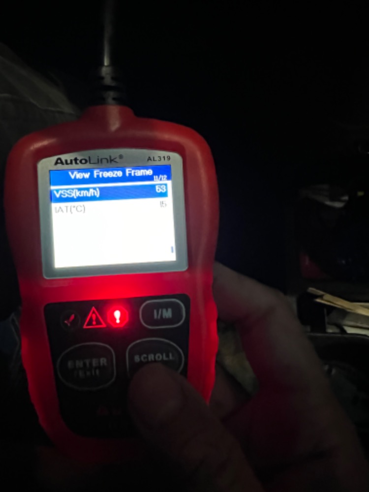

your iat temp looks low , also might want to check evap purge not staying opean. good luck
