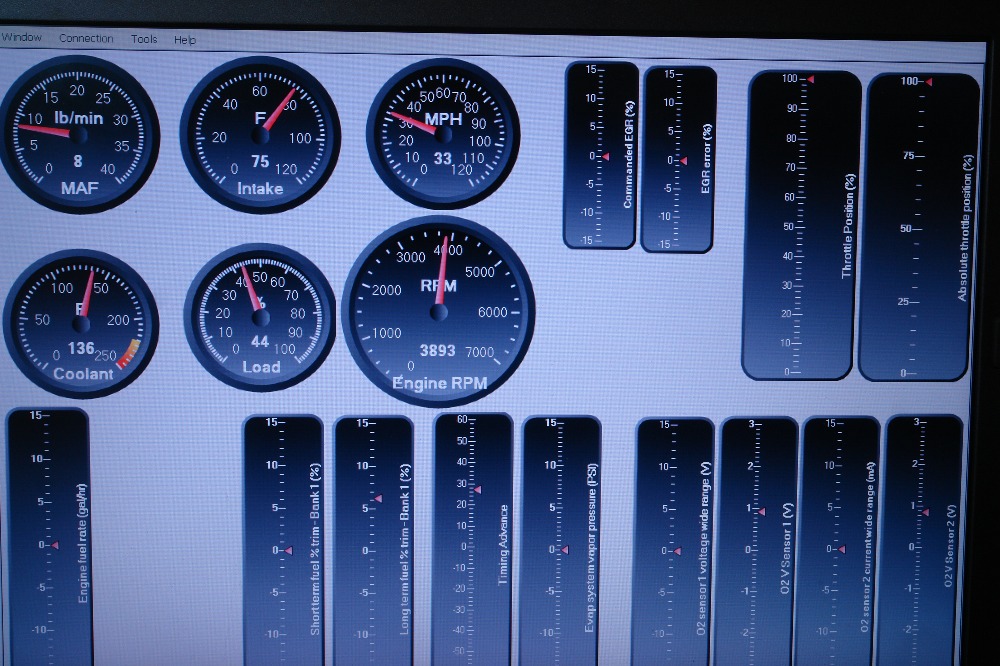

9 years 3 months ago #10958 by StepSide88
Replied by StepSide88 on topic Re:02 GM 3.1 403-5 DTCs
OK I have some of what you ask for.
RE Fuel Pressure. Not supported so I hooked up the gauge and watched through the windshield.
50-55psi the whole time.
This photo is the data as it read on the 'dashboard' of the scanner.
I could also post the Strip Chart view but this view shows the most data in one shot.
On 100% throttle it bogs bad
@25% it accelerates fairly smooth up to 30mph.
To be honest I'm not sure I fully grasp which reading of the STFT indicates rich or lean.
I'm going to guess Higher O2 readings indicate leaner fuel ratio?
I am much more inclined to do the EGR exhaust pressure test than the up stream O2. I had to pull the EGR to make enough room to get down there anyway!
I'm going to wait until I see the feedback from this post

Wow is this a maf engine? Your only getting load to 44%! If this has a maf get it's reading at idle and at wot

Very good data here, BTW. This is exactly what we needed. The low Load and low MAF readings are an indication of poor engine breathing. The upstream O2 is showing close to 1V (rich), which means the cause of the low power is not likely to be related to lack of fuel. Your fuel pressure reading tends to back this up.
The short term and long term trims aren't valid during this WOT test, as the PCM goes into open loop and stops trying to 'trim' fuel. Once you go back to just cruising along, closed loop will probably kick in, and the trims will start moving again.
Sweet! :lol: I'd say do that test next, as your WOT data is suggesting a plugged cat. A restricted intake is also a possibility, but less likely. If your backpressure test comes back negative, then let us know and we can suggest further testing.

6.21 lb/min is around the airflow rate that we saw in your screen capture during WOT, so it makes sense that the P0300 set around the same time. Poor engine response under heavy throttle, but acceptable acceleration under light throttle is another common symptom of a restricted exhaust.

Idle rpm 894
MAF @ 894rpm 1 lb/min @99 sec. ---- 0.9 lb/min @ 128 sec
Load 4-5
MAF @ 3893 rpm 7.4 lb/min ---- load 44 approx. = WOT
