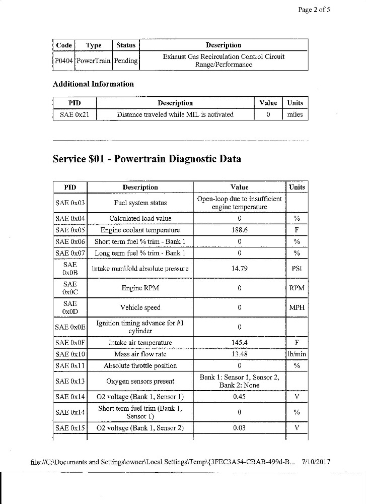

The Service $01 SAE 0X10 MAF read 13.48 lb/min if that helps.

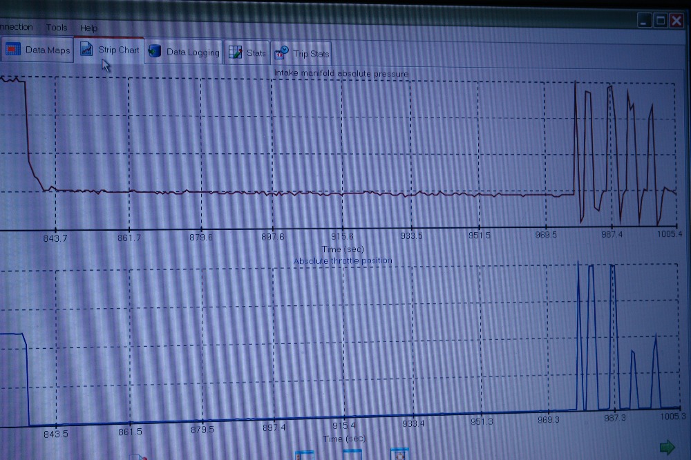

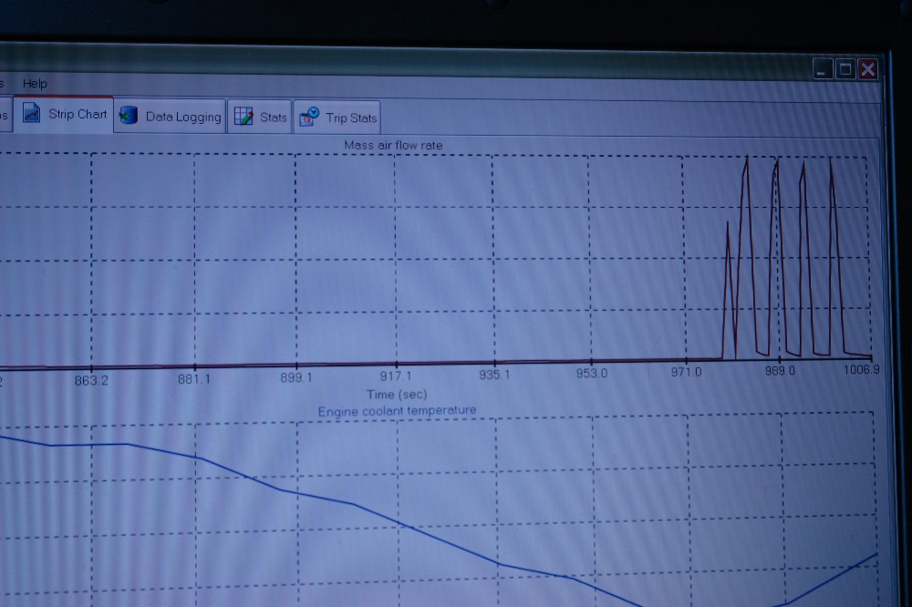

Here's a throttle blip a few mins after the 6.5 minute section of the EVAP Drive cycle.

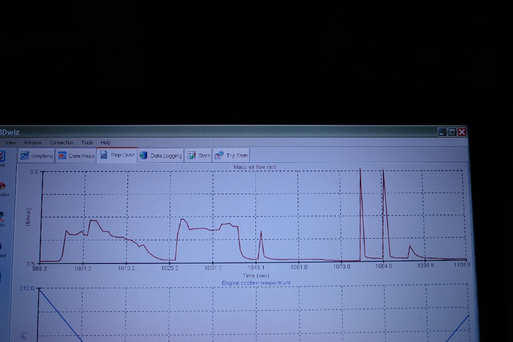

9 years 3 months ago #11068 by StepSide88
Replied by StepSide88 on topic Re:02 GM 3.1 403-5 DTCs
Oops thats not the MAF
bottom of one top of the other

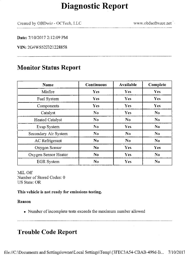

After the 45 min cool down after the drive cycle I checked and got this;
Monitor Status Report
Name Continuous Available Complete
Misfire Yes Yes Yes
Fuel System Yes Yes Yes
Components Yes Yes Yes
Catalyst No Yes Yes
Heated Catalyst No No No
Evap System No Yes No
Secondary Air System No No No
AC Refrigerant No No No
Oxygen Sensor No Yes Yes
Oxygen Sensor Heater No Yes Yes
EGR System No Yes No
MIL Off
Number of Stored Codes: 0
US State: OR
This vehicle is ready for emissions testing.
I literally had not see the "Ready" until I was in here posting the copy/paste from my program.
I did have to change the battery before starting this AM. but it has been acting poorly due to long periods of diagnosis.
I'm not ready to declare this fixed yet , it is nearly ready for a freeway on ramp though.

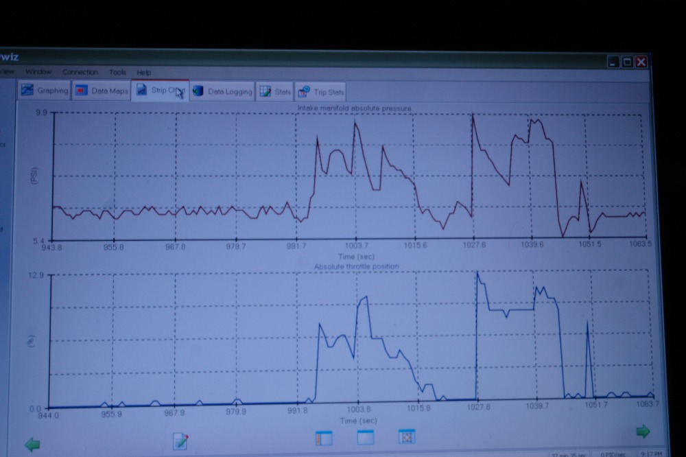

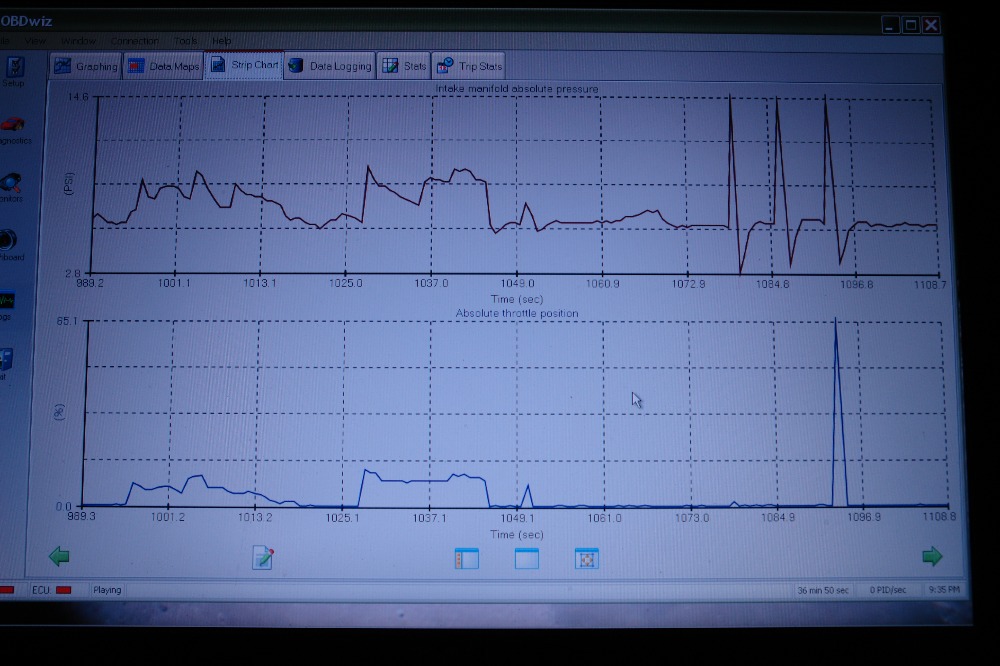

Wow that graph looks very suspicious at the end your map and maf show 3 throttle snaps but your tps only shows 1 but the 1 that the tps shows the maf barely reported at all this could be a issues with your obd2 adapter lagging what adapter are you using?

Ben wrote: Wow that graph looks very suspicious at the end your map and maf show 3 throttle snaps but your tps only shows 1 but the 1 that the tps shows the maf barely reported at all this could be a issues with your obd2 adapter lagging what adapter are you using?
Here is a look at todays run.
Time window is 180sec in this view
the blips are after the 2 min idle .
This OBD adapter and program is called OBDWIZ.

9 years 3 months ago #11097 by Ben
Replied by Ben on topic Re:02 GM 3.1 403-5 DTCs
Were all 5 of them wide open throttle the last 2 are only showing 50% on the tps but the maf and map seemed to report close to 100%?

I believe the TPS is correct. I have yet another one from this AM's drive I'll try and grab a shot off when I review it.
