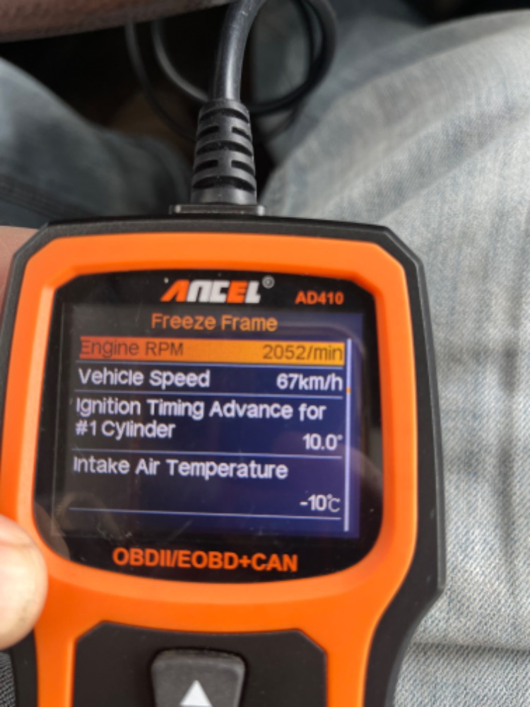

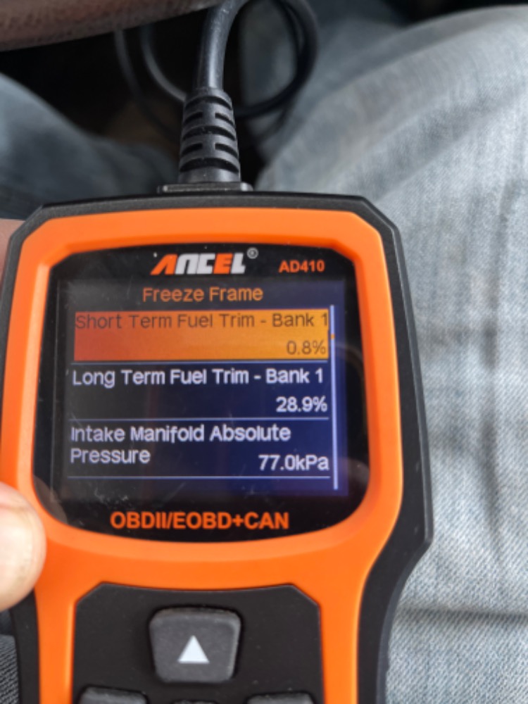

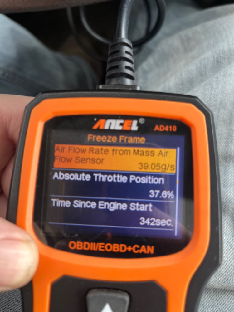

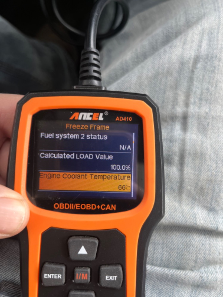

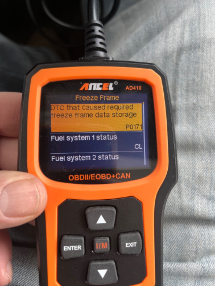

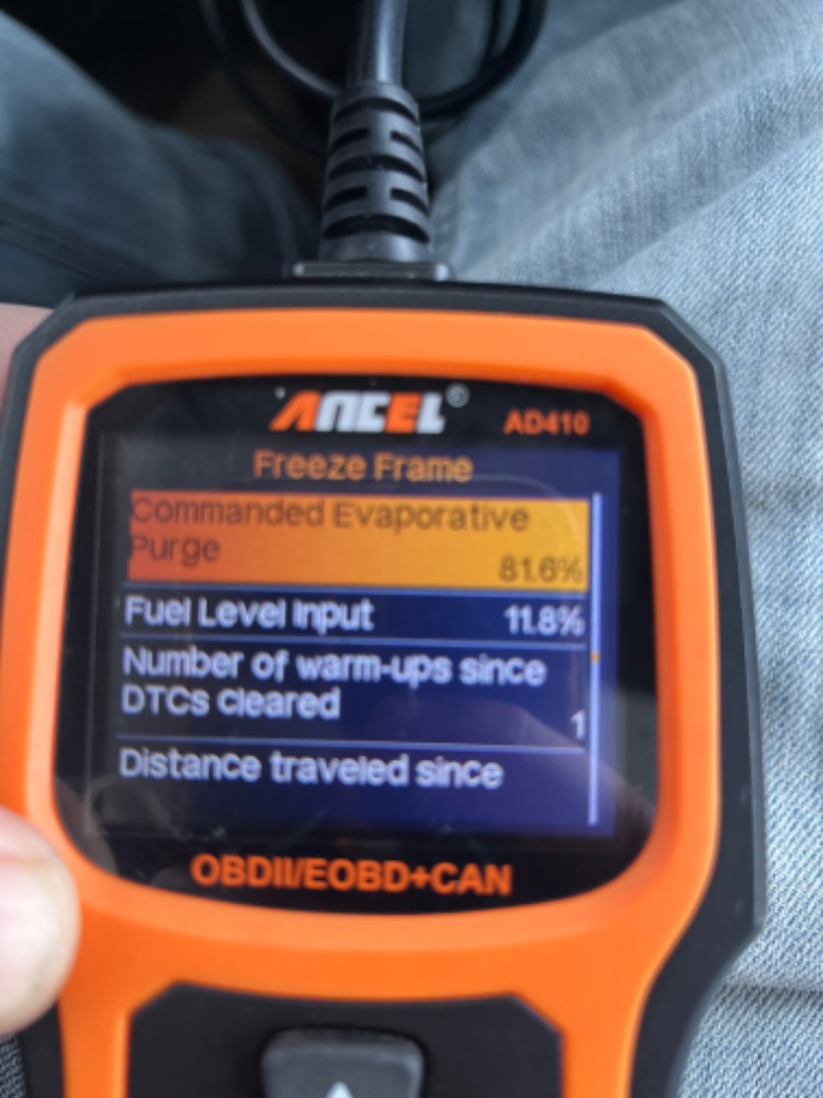

  • OGChrome
  • OGChrome's Avatar Topic Author
2 years 9 months ago #64383 by OGChrome
Replied by OGChrome on topic 2011 Malibu 2.4 ecotec p0171
This is my freeze frame data.  I’ve driven around watching and recording live data and in both the freeze frame and live it’s always been closed loop. Maybe something here could answer what other pids might be needed.

My apologies, I only just noticed it’s reported everything in metric. There are 5 more pictures of the freeze frame I hadn’t yet uploaded when I noticed it was set to metric. If you need to see freeze frame data in standard (all 11 pictures)  I’ll have to switch the scanner to standard and get new photos. Let me know if you want to see all 11 pictures of the freeze frame in standard measurement system. Also let me know exactly where we are in the process, what we need to determine and what pids we need next. Keep in mind that I can only graph 3 pids at once. I am happy to take a video of 3 then another 3 and upload them all together. Just let me know which 3 at a time on each graph screen is needed.
