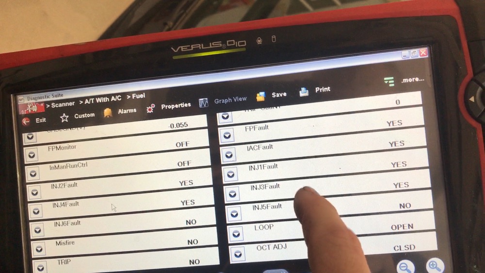

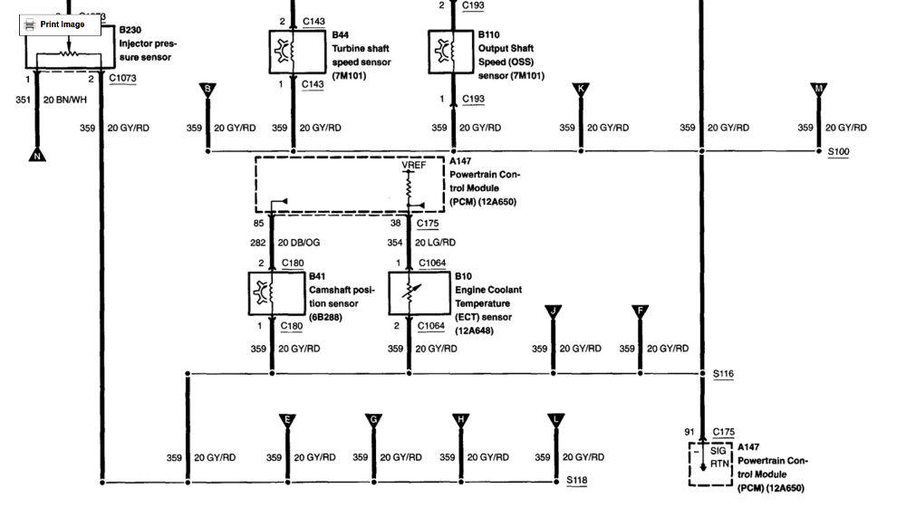

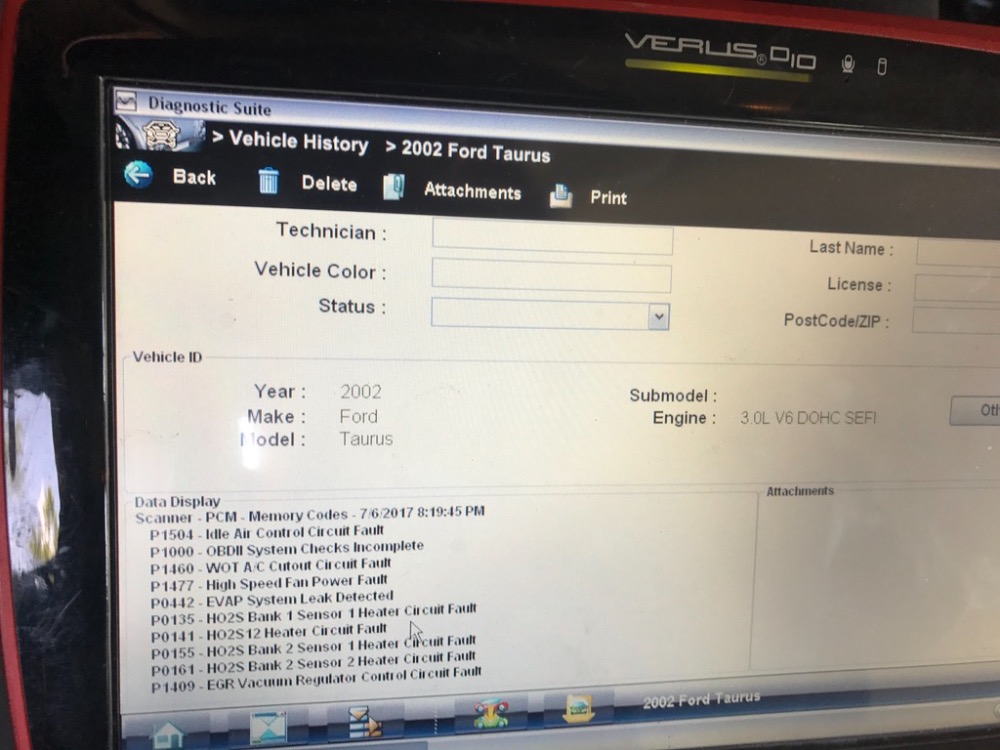

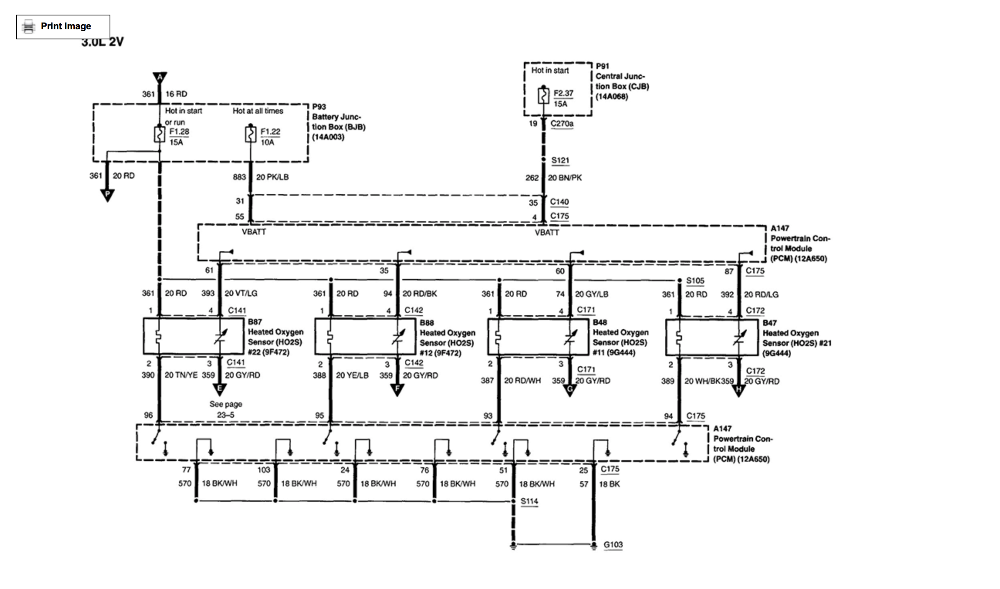

Alright so where to start with this one... Well Ive got pictures hopefully attached that show all the codes and the data list with the faulted injectors and IAC. Also a wiring diagram for the O2 heaters and the O2 signals themselves. There will be a link later with the testing I did to a video on youtube as soon as I get it done and would love to hear everyones thoughts on what they think is wrong. But my starting question is this signal return on a Ford pcm is the same as a ground right?
Follow up to come later this week with video.
