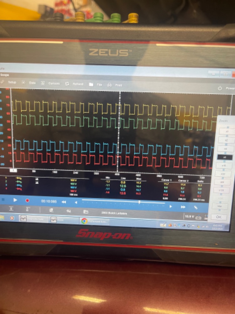

This is a capture of my key cycle (on/off) of my 4 wires stepper circuits. To me they look good. What bothers me is i have capability of bidirectional control over the IAC but sometimes it responds and sometimes it doesn’t? To me that seems intermittent as if it’s coming and going… again the stepper is new and here’s a capture of the key cycle…

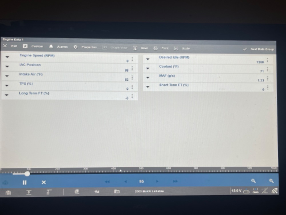

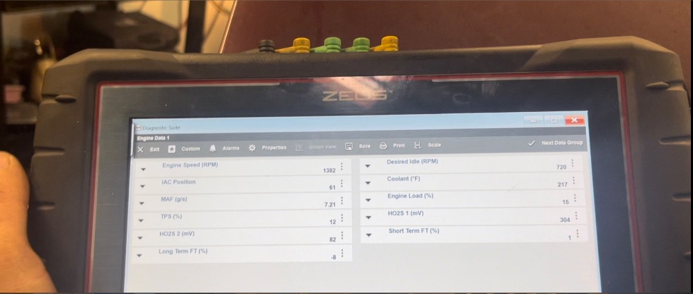

Here are two screen shots of data pids. If you need me to bring up other pids just say so and I’ll add them.. one is cold engine (it sat over night) the other is of the vehicle idling at operating temp. I’m not manipulating the throttle in any way, this is how it’s idling at times… Most of the time.. today I started it and it ran fine, idled fine. But when it’s not idling fine rpm’s are 1400 to 3000…
