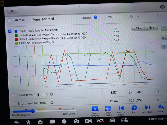

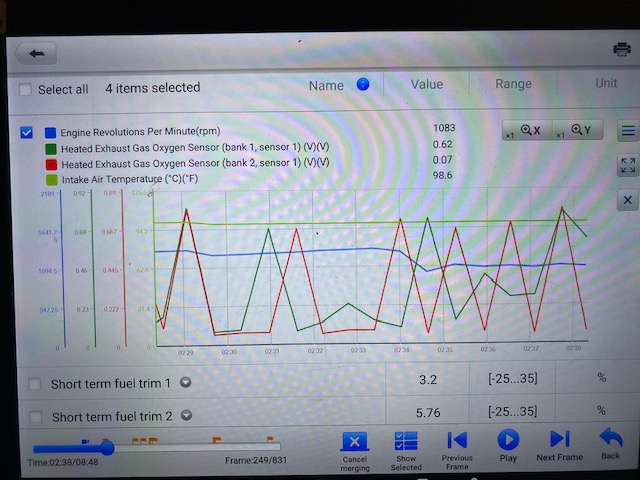

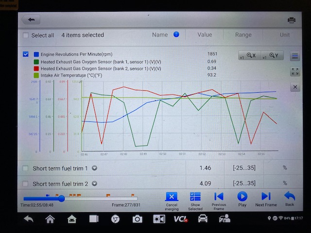

Ran WOT and monitored IAT and front O2s.  Hopefully my attachment shows up, not very computer savvy, lol.

When you get a chance take for a drive and graph both the long term and short term fuel trims for both banks. I would throw in calculated load % paid also. Your O2 sensors did what they should at wot. I see the upstream sensors were replaced, I would just confirm not a chance O2 harnesses accidentally got switched and plugged into wrong banks. Just nice cruise, do not need pedal to metal. Just curious, is Bank 2 Sensor 1 switching normally?

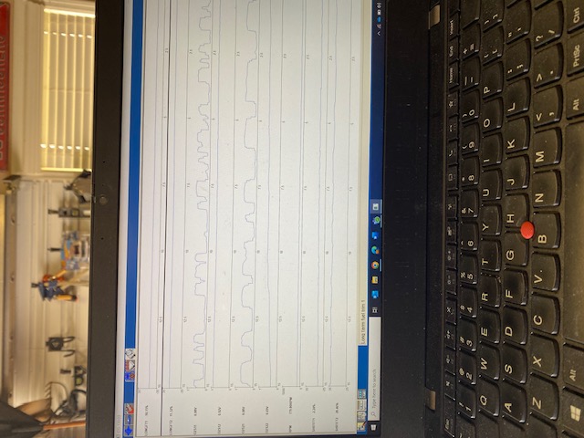

Will have to road test another day. Will update after next road test. With scope, O2s were switching nicely. With IDS and graphing PIDS, they are erratic, same with Autel. I'll try and upload other pics shortly.  The O2s are connected properly. Bk1s1 connects at the back of block near bk1 head.  Bk2s1 connects under vehicle near shift linkage of trans.  Both rears are similar, BK1s2 connects near the starter and Bk2s2 connects near the top rear of trans.  The harnesses are not long enough to switch connection points.  I double checked that early on.

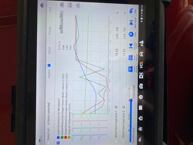

Road tested from cold start to operating temp. recording LTFT/STFT and engine load.  Trying to get video uploaded to youtube to share.  Also recorded front/rear o2s along with MAFs.  Not sure about MAFs reading from Autel, it differs from IDS.  Vehicle did have OEM mafs, i replaced with a used one from an 09 ranger, same part number, no change to fuel trims. This is the link for the O2s recording,

Here is the link to LTFT/STFT and engine load. This  was from cold start to operating temp. The O2s video is at operating temp.

Your O2s and Mafs video - I noticed the mass air flow sensor read 0 until into 1 minute 15 seconds of the recording. If there are no vacuum leaks anywhere, and you can not find any -this displays all the symptoms of a bank blockage, but your back pressure test throws that thought out the window lol  I think time to put a smoke machine on this truck. Thoughts anyone?
