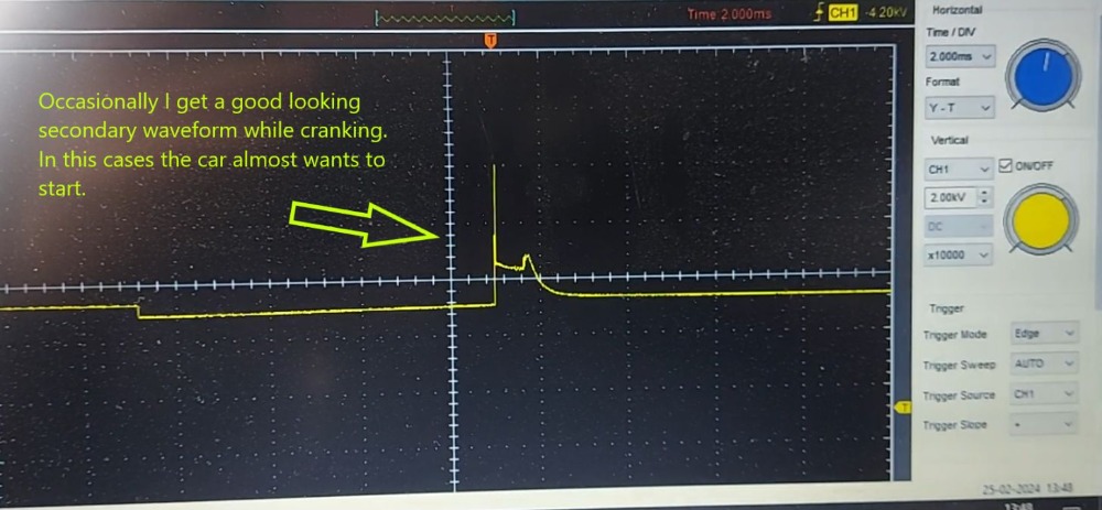

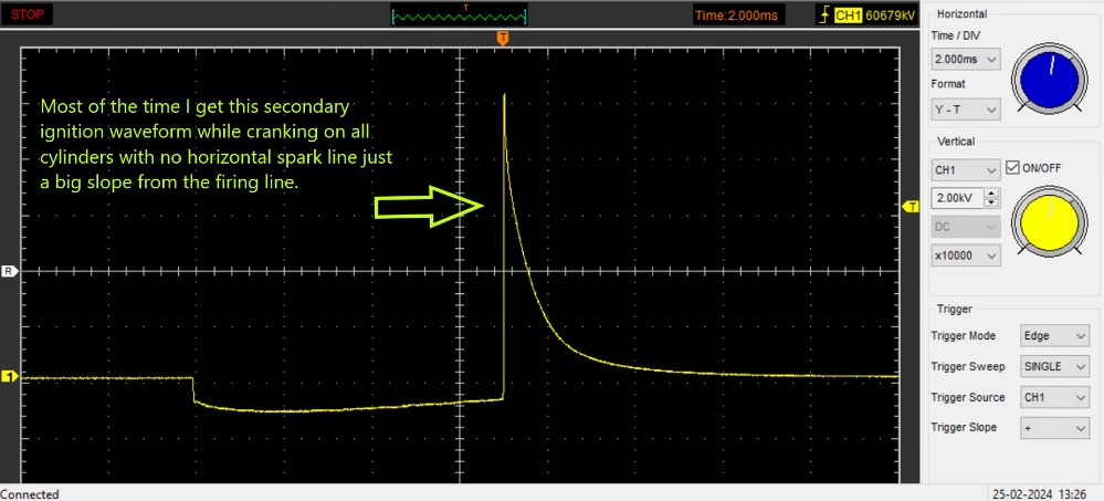

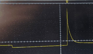

While checking the secondary ignition with a scope, I noticed a strange secondary waveform with no spark line. (see: image ) Occasionally, it produced a correct secondary waveform with the horizontal spark line (see: image ), and the car wants to start in these cases. All cylinders produce this bad secondary waveform. Here is how it looks like on the scope: image
Also a short video that shows cranking with bad secondary waveform and you`ll see it produces a good waveform and the car almost wants to start: streamable.com/a6mzgv
Occasionally, I can hear small booms (explosions) from the throttle body while cranking. I guess unburnt fuel exits through the intake valve.

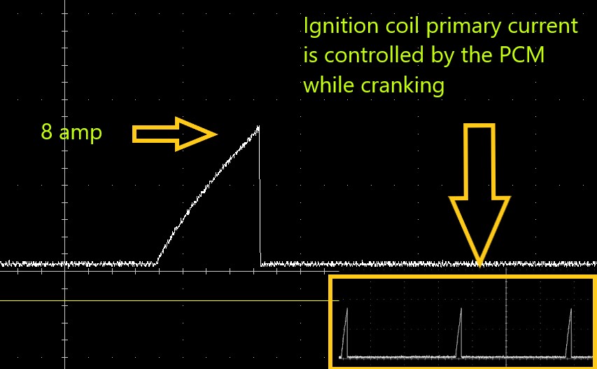

I replaced the ignition coil, but the problem stayed the same. No spark line in the secondary waveform. I tried to find similar bad waveforms on the net with some explanation, but no luck. I have no idea what can cause such a bad secondary waveform without a spark line. HT leads? Spark plugs? Its like something is blocking the spark from forming. Do you have any idea?

- Fuel injectors: There is PCM control while cranking, not stuck open or closed. Also, tested flow looks good.

- Ignition coil: It is a waste spark system; the coil pack gets power (12V), and PCM provides enough current (8 amp) when firing the coils. (see: image )

Love the secondary captures.
Thanks for including those!
That gentle slope down from the firing line is usually an indication of a secondary circuit short to ground, IMO. Water in the spark plug tubes, coolant/fluid across the spark plug gap, wire grounding out, like that. Not saying your Focus actually has any of those specific problems. Just giving examples of what I've seen cause that ignition waveform.
The engine doesn't sound like the piston rings are washed out, but I'd be tempted to pull the spark plugs and check for fouling anyway. If the plugs are wet with gas, dry them and the cylinder out as best you can. You can also try feathering the throttle during cranking in an attempt to get the cylinders dried out enough to start. Take care not to overheat the starter, and have a battery charger/jump pack handy.

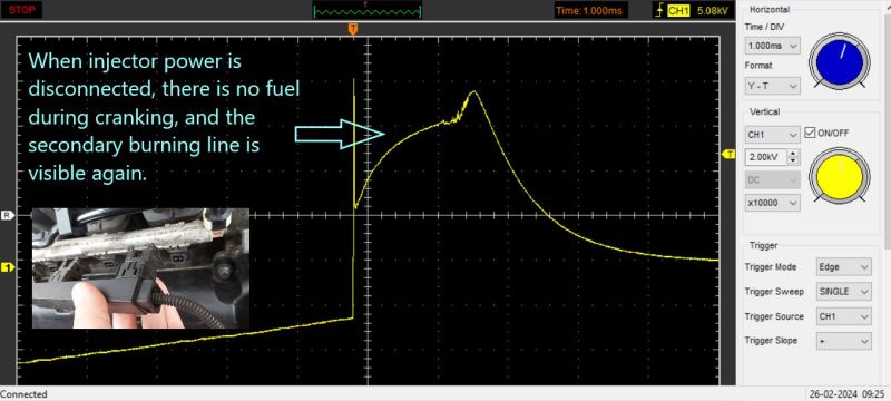

Thanks, Tyler! Your hint regarding the fuel injectors was really helpful!

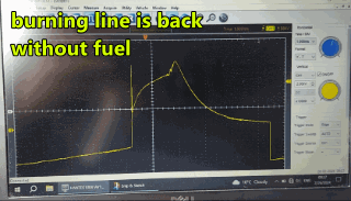

The secondary burn line is back (without fuel)
I thought that if the missing burn line in the secondary waveform is caused by a fuel issue, then simply cutting the fuel while cranking should show a change in the secondary waveform. So, I disconnected the injectors from the power and checked the waveform again. Now, the burn line in the secondary waveform appeared, confirming that the issue is definitely caused by fuel in the cylinder, and the ignition system is fine.
Here is the video of the secondary waveform with the reappeared burn line while cranking.
As you can see no the burn line is definetly visible while cranking whithout fuel:
The injector curret test was good

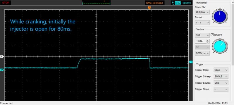

I checked the fuel injector current waveform, and the PCM definitely controls the injectors, creating a quite long pulse of 80ms while cranking. As I mentioned, I already checked the injectors; they are neither stuck open nor closed and can hold pressure. Additionally, I performed an injector balance test, and all injectors were found to be in good condition.
Here is the video of the injector current while cranking.

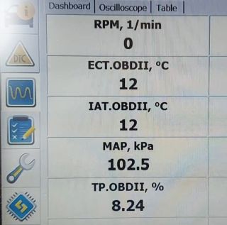

Now, I suspect that the PCM floods the cylinders with fuel, preventing the plugs from producing a spark. As you suggested, I checked all the sensors that might be related to injector pulse while cranking:
- Engine coolant temperature (ETC): 12°C (53°F) - matches the actual ambient temperature
- Intake air temperature (IAT): 13°C (55°F) - matches the actual ambient temperature
- MAP: shows vacuum while cranking
- Throttle position (TP): I was moving the accelerator pedal while cranking and I could see throttle position value changing on the scan tool. (In reality it was not moving.)
