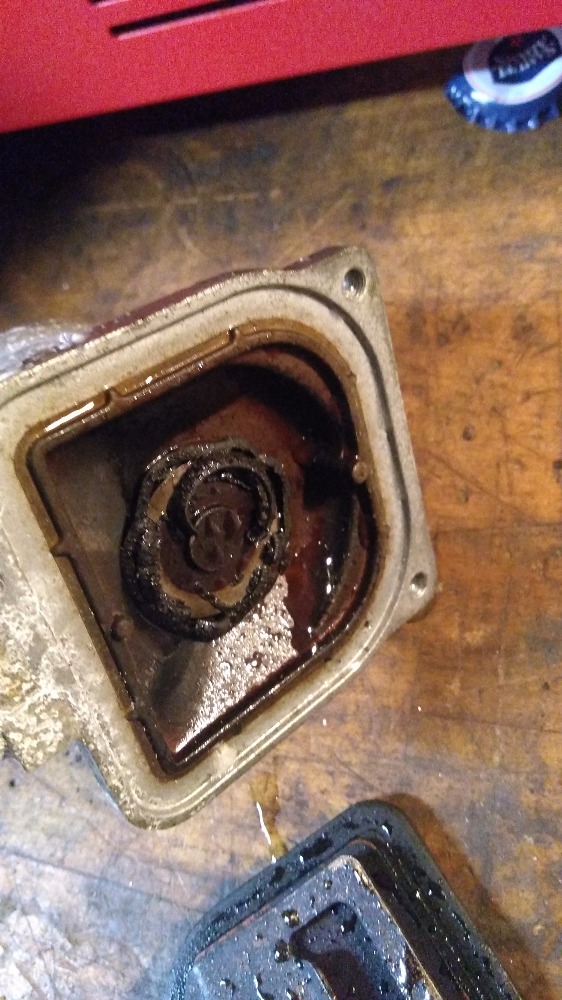

  • Tutti57
  • Tutti57's Avatar Topic Author
9 years 3 months ago - 9 years 3 months ago #11218 by Tutti57
Replied by Tutti57 on topic 2010 Impala p0411 - Fixed
It was the valve. I ended up taking it off and dismantling it. I imagine at one point there was some sort of rubber diaphragm in there but it was all in pieces. With it removed from the car I plugged it in and it was doing nothing when I activated it's relay. The new one made a distinct plunger sort of sound.
Im still not sure what to make of why the O2 went lean when I activated the system. I guess I just don't know know exactly how that part works, even after having it all apart. I'll post a pic to show the inside.
Last edit: 9 years 3 months ago by Tutti57. Reason: Added pic
