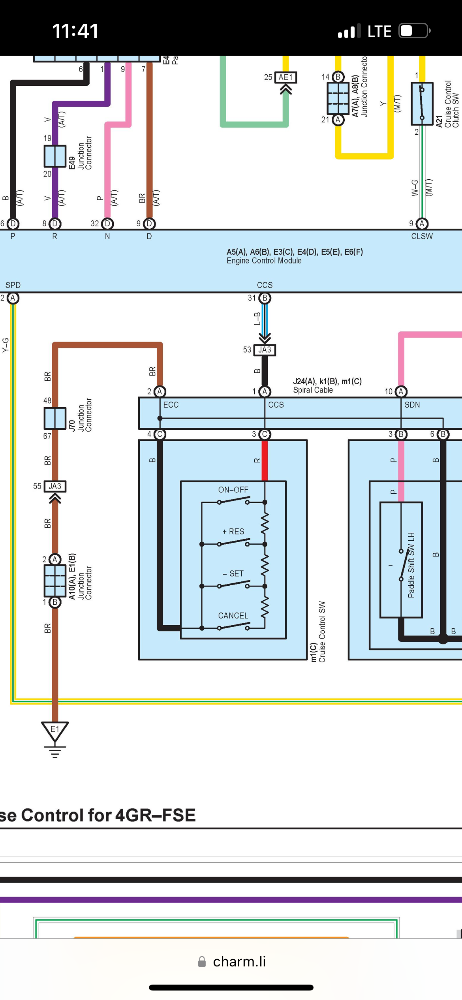

Helping a friend diagnose his cruise not working ( no illumination and cannot set speed, zero fault codes) car did receive a donor engine as previous owner over heated and blew head gasket / warped the head. ( I use an aultel mk906 will it reinitialize the SRS system and such if I start taking apart the steering wheel and removing airbag?)
I haven’t dug into it yet but I’m assuming it’s the combination switch that comes off the steering column.
my question is how to diagnose the switch other than just doing pin outs with the resistance flow chart.
from what I can see it’s a series of resistors that pull down to ground and the signal wire also is looped into other circuits ( assuming 5 or 12v pull down).
I not sure using a test light to pull signal wire to ground will simulate a desired effect because I would assume the pcm is measuring current or voltage drop to make the decision for whatever selection. I’ve included the wiring diagram , any help would be greatly appreciated!

Hey DDR223! From what I remember, Toyota/Lexus was not good about having scan data PIDs for the cruise control switch. Have a look with your Autel, but I don't think you're going to find any.
IMO your next easiest move will be to find pin 31B at the ECM or pin 1A at the clockspring, whichever is less work to access. Key on, backprobe the correct pin and take a voltage reading. Use every cruise switch function and watch for voltage changes.
You're right that this switch will pull the signal voltage down to varying degrees based on the position of the switch. In ON/OFF, the signal voltage will be pulled from 5V all the way to zero. When the ECM sees zero on that signal line, it interprets that as the driver pushing the ON/OFF switch. CANCEL won't pull the signal down much at all, because it's got three resistors between it and the signal circuit. The ECM could be measuring current? But I'd really doubt it. Pretty sure this is a simple voltage input.
This is a excellent test, IMO. I've done the same when testing these cruise switches. You could take it one step further by shorting 1A to 2A and see if the Cruise light comes on. That'd not only confirm the signal circuit, but the ground as well.If I confirm no on/off I was planning on removing steering wheel and back probing the pin 1 ( supply to switch) and shorting to ground with test light as it would appear that is what the switch will do anyway.
