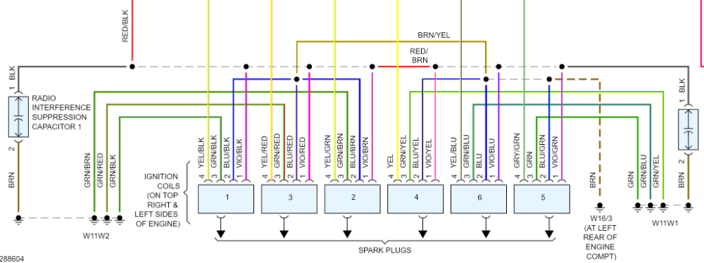

Hello everyone. New to Forum. Great information here and great teacher. Really enjoying the information.
My vehicle is stuck in Florida. I live in Canada.
I have a Mercedes Benz 2006 ML 350. Just replaced engine and have same issue as before it was done.
Right bank no spark or voltage at coils. Bank closest to battery has no issues.
Good voltage across engine comp. fuses and supply lines. Scanner says short on right bank all cylinders.
I have checked and rechecked the wiring as best I can throughout the vehicle.
Can I jump the 12 volt wires to coils? will it hurt my new ECU?
Thanks for your help.
Mark

Do the wires that supply power to the coils all share the same color? If so, that's usually the tip-off to the power supply wire. You might want to consult a wiring diagram for your vehicle just to make sure.
If that is the power wire, applying 12V would probably be okay, unless that wire was somehow faulty and shorted to ground.

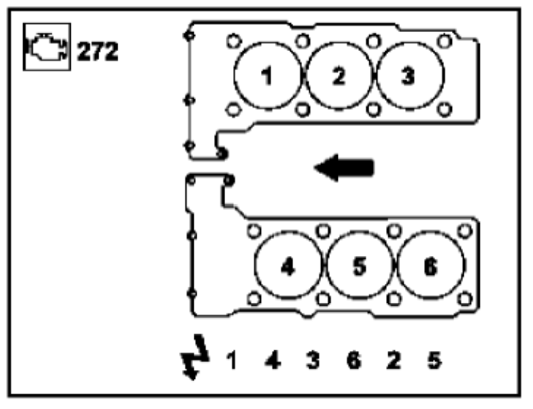

First off, let's be clear about which cylinders have no spark. This is the cylinder layout for your engine for reference:
Second, this is a wiring diagram of your ignition coils. Engine running, pick a cylinder with no spark and measure voltage at each of the four pins with a multimeter.
Let us know what your voltage readings are and we can help you further.

coils 4,5,6, the problem. no voltage.
.81 volts across 4,5,6 # 1 wire. should be 12v
.000 volts across 4,5,6, # 2 wire
.002 volts across 4,5,6 # 3 wire
.2 volts across 4,5,6, # 4 wire.

I connected a 12v wire to position 1, from the cylinders 1,2,3 to give me 12v on 4,5,6 and the engine started, ran and idled. I have power at the coils on 4,5,6. I then performed a cylinder drop and the engine responded on each. Still running a little rough though and engine light on but not flashing like before.
