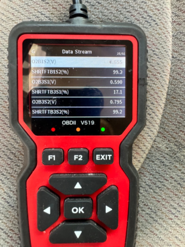

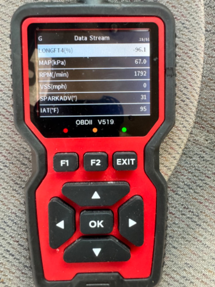

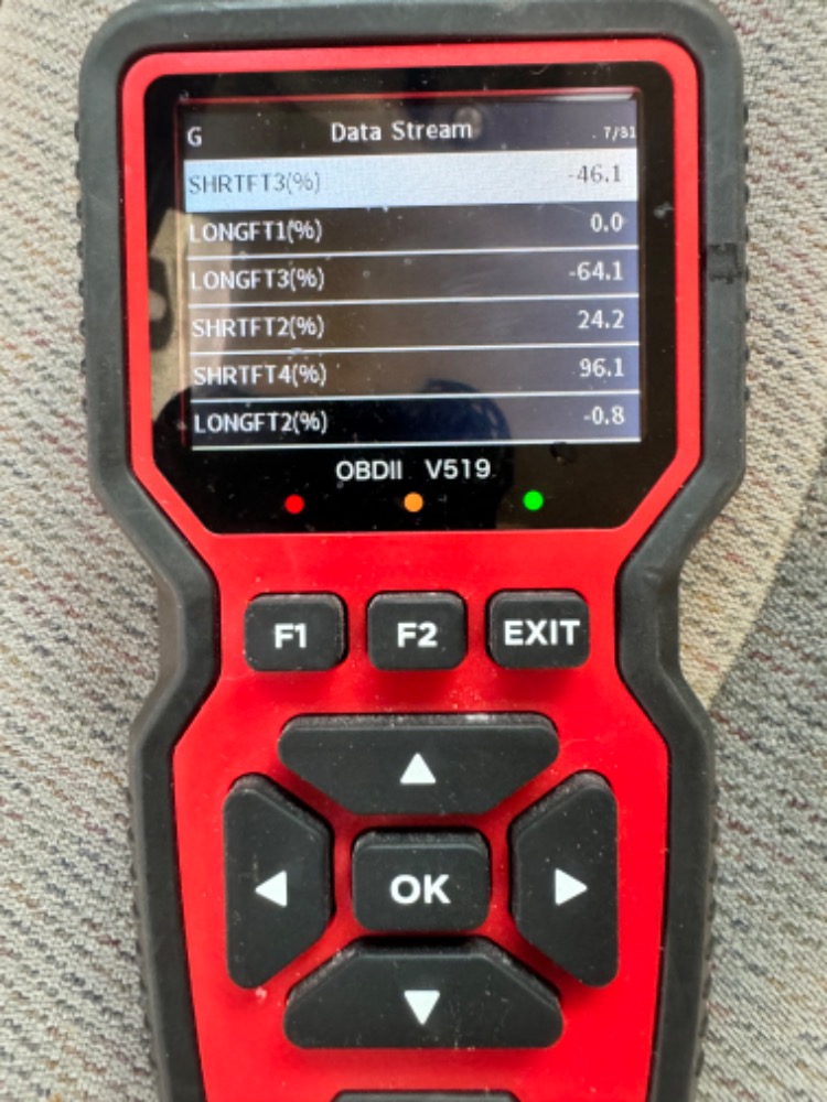

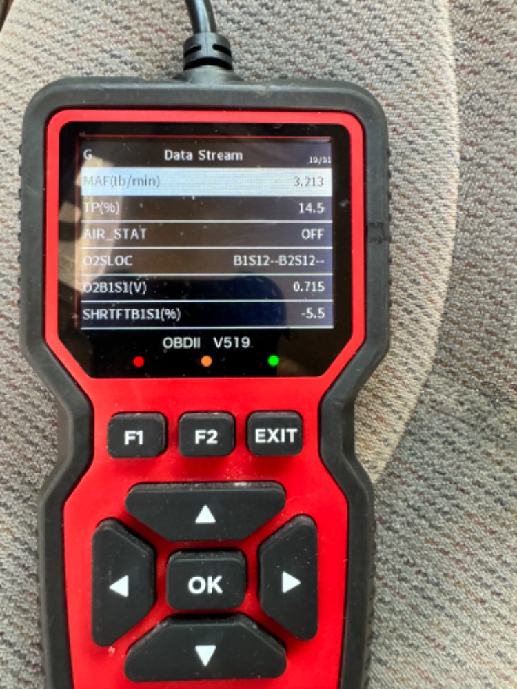

Good morning we have a 2000 GMC Sierra 1500. It has a 4.8 The truck was running fine all of a sudden it shut off very rough idol scanner came up P. 0300 and also the mass airflow sensor. We bought a new airflow sensor, actually changed spark plugs, wires thinking that was the problem. Everyone you speak with has a different opinion bought new fuel filter. Still doing the same thing got a can of Cleaner sprayed for vacuum leaks nothing cylinders 1357 when I pulled the coil wire off none of them on that side made any difference in the engine idol. We took this job on to help out a family in need it’s been almost a month can’t figure it out. The scanner says fuel trim numbers are super high.

2 years 7 months ago #65022
Looking again at your captures, most of those trim pids don't apply. There's no stft3 or ltft4. Those are probably just place holders with no real diagnostic value.
Replied by Noah on topic Hardest Code ever P0300
This is not the same as verifying injection control.I took out the injectors yesterday cleaned them put in this morning same thing high negative numbers
