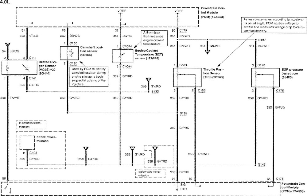

Does anyone have a wiring diagram for a 2006 Ford Ranger 4.0. Im trying to locate the the upstream wiring harness but it looks like that it was removed or cut out
2 years 7 months ago #65021 by Noah
Replied by Noah on topic 2006 Ford Ranger Wiring Diagram
