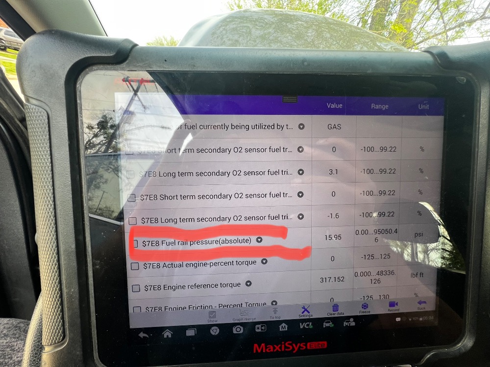

Hello guys . I got this code. P0087. Low fuel pressure. First thing i did. Was check data. I put the picture down here. After i disconnect the fuel line the one come from the fuel tank to the high pressure pump. And try to start. The kia. But there is no fuel. Come out of the fuel line . I check the fuse for the fuel pump. And its good. I went. To. Check power and grounds. At the in tank fuel pump. But. Its like 9 wires. And i not sure how the module on top the pump works. Any help i will appreciate.

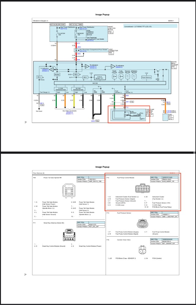

need a wiring diagram if you can get one. My guess would be the fuel pump is a module on the can network. 2 wires(power and ground for module itself), 3 wires for fuel level sensor, 2 wires to the pump itself(power and ground, its more than likely an electronic returnless with a PWM pump), and 2 wires for CAN hi and low. If you checked powers and grounds the pump and/or module is bad and needs to be replaced. Did you actually load test the powers and ground? High current loads need good dummy loads to stress the circuit.

Pin 9 black and pin 10 pink are ground and power to the integrated fuel pump module.
Pin6 orange and pin 1 grey are the wires for the level sensor
Pins 2, 4 & 5; blue, pink & orange are for the fuel pressure sensor also mounted to the pump module.
Pin 8 black and pin 3 white are data communication.

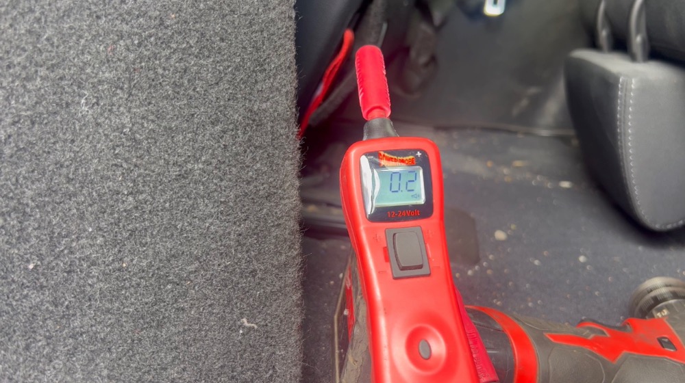

Hello. I use a power prove 3 to check the pink wire. At the fuel pump module. Is this enough to confirm a bad fuel pump. Check the video. Thanks again.

No, this is not enough to condemn the pump,
As Noah stated the pink wire is related to the (low) fuel pressure sensor. You will have to make sure power feeds and grounds to the module/pump are ok.
I don't doubt you checked it allready, but is there actually fuel in the tank? I've see stranger things happen...

Ok. Pin 10. At the fuel pump module Is. The pink wire. Thats the one. Should be 12 volts. So. I put 12v. On that wire and the kia start right up. So the problem is. The ecm not grounding the fuel pump relay. Or. The relay is bad. Do you know where i can get. The. Wiring diagram for it.

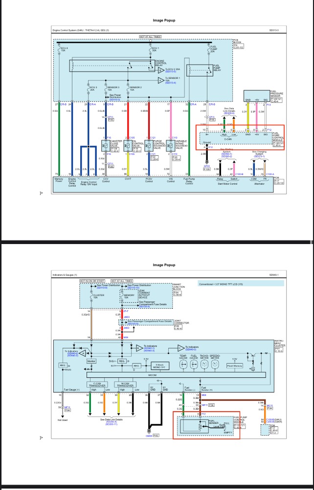

Do you guys know where i can get the electric diagram. For. The fuel system. Now. I need to know. Which whire is the ground signal from the ecm to the fuel pump relay. If the ecm is sending the ground signal to the relay. Because the relay is not getting active to send power to the pump. Then the problem is the relay. Which. Is the all fuse box. Im using this diagram from 2018. But is not the same.

The load side of the fuel pump relay gets power from the 20A "fuel pump fuse".
The control side of this relay gets power from the 10A "sensor 3 fuse".
The relay is ground side control and the control wire runs to the pcm connector "C 300 K", connecting to pin 33.
There is another connector "EC11" in between relay and pcm where the wire color changes from green (coming from the relay) to yellow before reaching the pcm.

by gerber
Replied by gerber on topic 2020 kia sorrento 3.3 code p0087
Do you have the diagram. Because the one i showed at the las post is for 2018. And its not the same. For the 2020 thank you

The description of fuses and terminal numbers I gave in my last post are from the 2020 diagram. I'll look how to upload it tomorrow.
