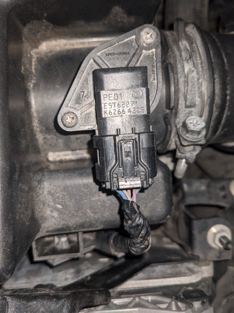

I have a 2014 Mazda Axela (the Japan version of the Mazda 3) and i've been getting the P0171 code lately.
Did all the basic to rule out a air leak (did a smoke test) even had the PCV valve checked and replaced.
Online search showed that the most likely issue and fix is to have the MAF changed, issue is, I have a 1.5L engine version of the care (1490cc engine) and all the replacement MAF sensor I can find are for the Mazda 2.0L engine.
Does this matter?
Can I use a replacement MAF for a 2L engine on a 1.5L engine?
MAF Model #
PE01 - E5T62271
Pic of current MAF Sensor Model attached

You may want to look up the MAF part numbers for the two different engines. If they are the same then there should be no problem.
There a re some steps which will help to diagnose ther root cause of the P0171: What does freeze frame data tell you? How are the fuel trims under different loads and rpm, typically you want to check them at idle, 1500rpm and 2500rpm.
Does the O2 sensor go rich under WOT?
Is the fuel pressure within spec?
