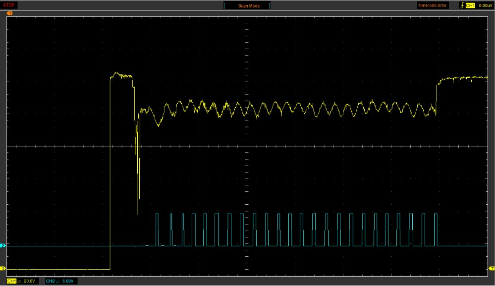

Your picture is coil negative voltage?
That's not right.
What is your voltage scale set at?
Take a capture of coil positive voltage too please.
That's not right.

I checked all the wires coming in and out of the ICM and coil with the oscilloscope. ICM wires A (power in) and D (coil driver) both have the same signal. Wire B (ECM signal in) has the 5 volt square wave (image below). C is ground and has no signal. All 4 wires on the coil have the same signal in the image below. I attached a diagram of the ICM and Coil wiring. For all readings except ICM wire B I used 20v with the x10 setting with a time of 500ms. Thanks!

There is no coil negative control going on there but it should be. That icm is not doing its job. Make sure the icm body itself has a good ground.
Scratch that the icm has an external ground, make sure that pin is not spread apart.
If that is good, get another ICM, BUT make sure your ignition coil primary winding isn't shorted (which would kill a new module)
