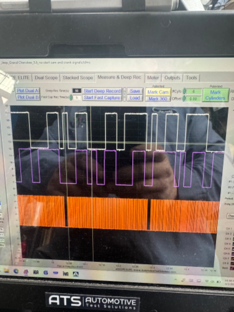

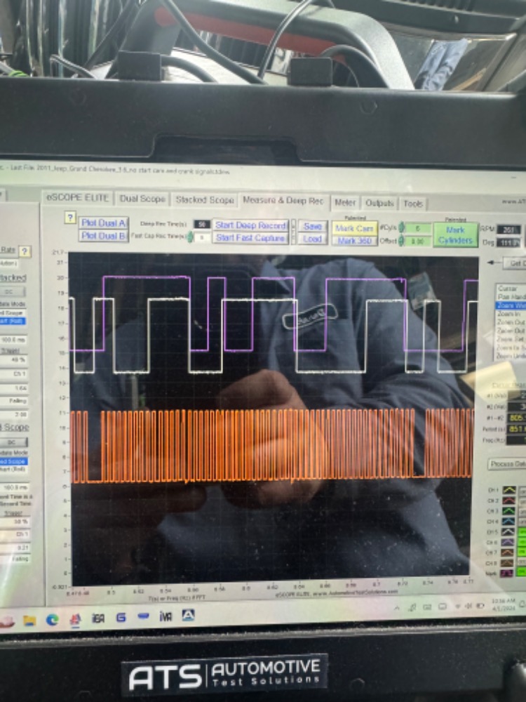

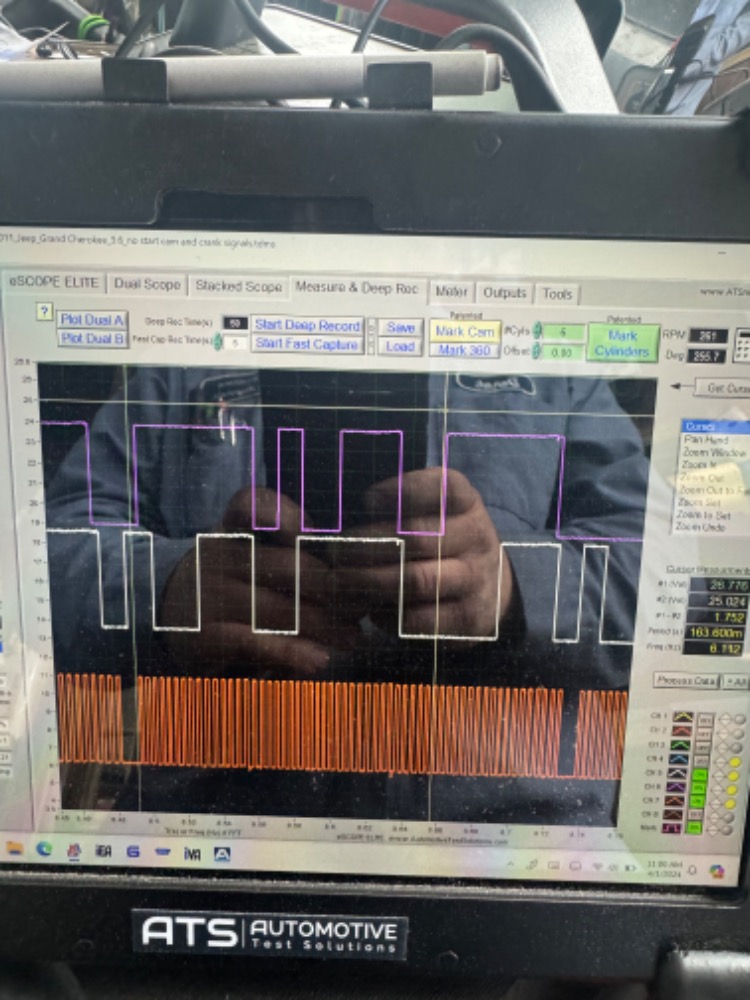

It’s a no start. Codes P0300 and P0174
in mode 6 only bank #2 shows 200+ misfires on every cylinder on that bank. 2,4, and 6
see if anyone got a known good waveform of the crankshaft and camshaft sensor. I’m pretty sure it’s out of time.
