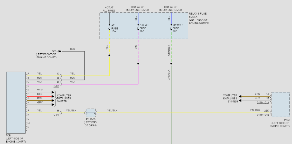

Hey ertomas! I snipped the relevant part of the transmission wiring diagram for reference:
Based on your testing, I think it's pretty safe to say there's a short to ground inside the transmission. On this transmission, the TCM itself is integral to the valve body itself. That'd mean at least dropping the transmission pan for inspection and possible replacement. Programming would also be required after valve body replacement.
As far as getting it out of the parking lot, there are two things I can think of that you can try. One would be to cut the yellow wire in a repairable location near the transmission connector. Plug the transmission back in and see if the TCM will power up and communicate without power from the AT fuse. If you can get the TCM to communicate, the engine may start and allow you to limp home (which hopefully isn't far).
You can TRY a bigger fuse, but that comes with risks. Overheating terminals and wiring, for one. Damaging transmission internals would be another. I'd probably find a way to tow it home before doing this.
EDIT: I'd also suggest pulling the fluid level dipstick and check for coolant in the transmission fluid. If you find coolant, I'd go straight to transmission replacement.

For (1), it would be as if the the fuse is removed or blown, and looks like that wire can’t be bypassed since it supplies power.
For (2), you confirmed the yellow wire is shorted from the transmission as the fuse blows when you connect it and as Tyler pointed out. It’s possible, though unlikely, there is a short in between, but if the fuse only blows, consistently, when you plug in the connector to the TCM, I doubt there is a short in the harness.

It would be the equivalent of the fuse being blown, yes. My hope was to fully eliminate all other components and wiring powered by the AT fuse. That way, you can know for certain that the short is inside the transmission. Plus, I was kinda hoping the TCM would communicate with just one power source.
2. If I wanted to confirm if there is a short with a multimeter there would be one or more pins with zero resistance when measured with the ground pin? I want to test the TCM connector and the wire harness itself.
Pin A at the transmission connector would show zero ohms of resistance to ground (or very close to it) if you checked it with an ohmmeter with the negative lead connected to B-. However, if you cut the yellow wire like I suggested above and the AT fuse no longer pops, then the resistance measurement becomes redundant.

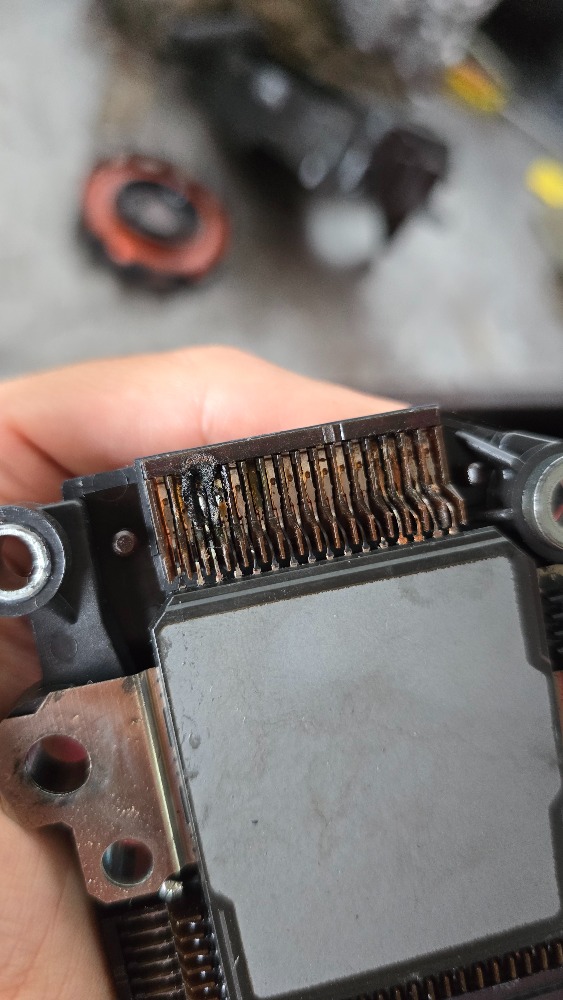

So, an update on this...
The TCM is indeed fried. I replaced the valve body, the car starts and drives.
​​​​​​The strange vibrating issue that I believe is the torque converter still persists.
Thank you guys for your input. ​​​​​​
