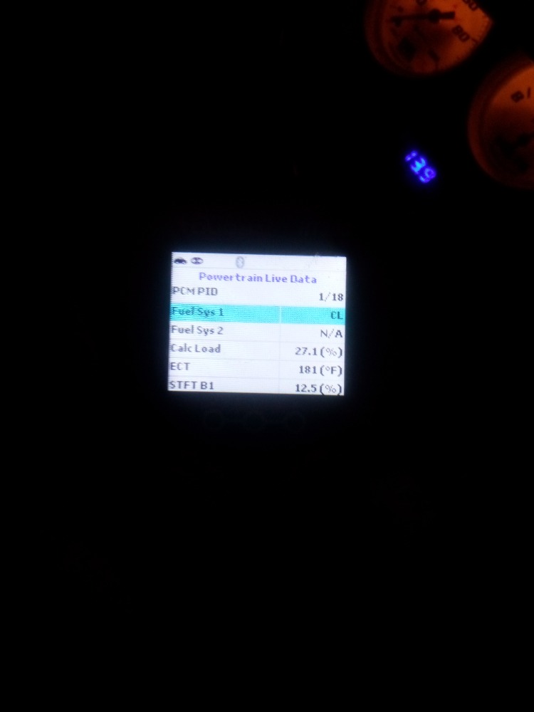

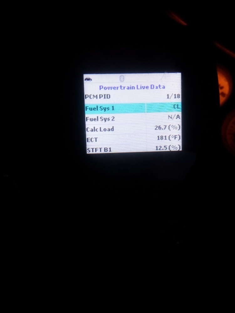

Hello I'm val and when I hooked my 1999 Honda Accord 2.3 VTEC  to my OBD2 scan tool my calculated load value is reading at idle 26.7% and I was wondering if that was normal for my Accord.

I see load anywhere up to 36% @ idle on some cars.

The calc. load value looks reasonable to me. The STFT pid is higher than I would like it.
Does the engine exhibit any problem or is she running fine?
